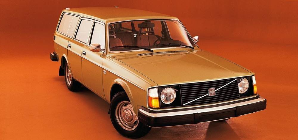

i'm surprised they didn't go for the single-round headlghts to go with that flat hood. thats almost certainly a conversion.
I'd take a close look at the grill, the long nose hoods were matched with a grill that stuck out, and most of the flat hoods had a completely different much wider grill with much smaller headlight assemblies...
like this 78...
Old Feb 5, 2020 | 09:04 PM
early long nose...
Old Feb 5, 2020 | 09:08 PM
here's a US market 1985 with the twin rectangulars. again note the grill sticks out...

Very interesting setup. As Pierce points out that if it is a conversion, I don't know how they got the grill to match up so nicely. You'll have to look behind the grill to find out if it all was adapted. Certainly the headlights could have come from a long nose but the grill doesn't look that way.
Old Feb 6, 2020 | 02:13 PM
another note, those early years didn't have a chin spoiler, but that had appeared by 1985 (and probably earlier).
also the early years, the bumper was different, with metal top and bottom, by 85 they had adopted the 'hockey puck' trims on the top of the bumper with chrome flashing, your car appears to not have these but looks like the later style bumper.
