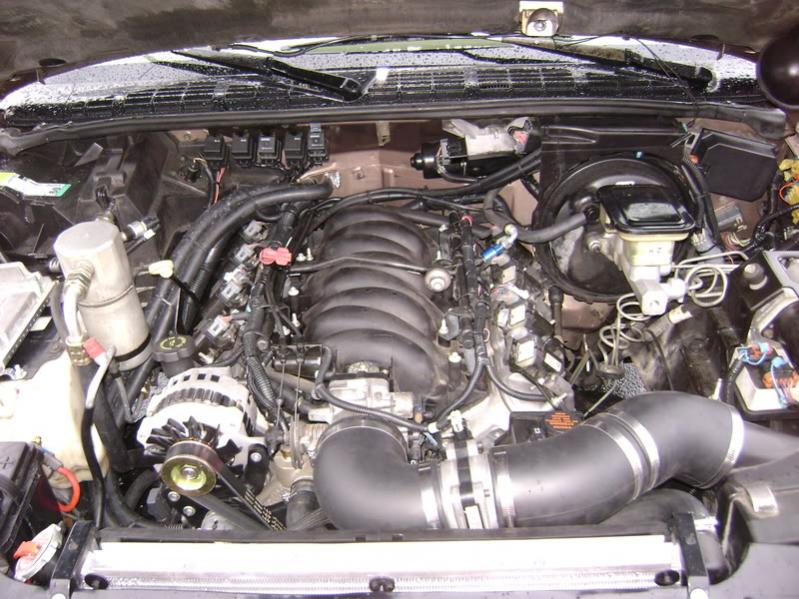

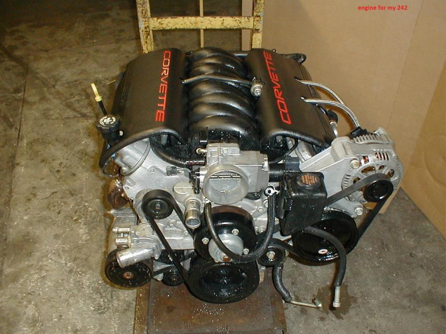

I've never put a ls1 in a 740/940,but have installed them in 240's and a couple of s10 blazers.The car can handle the power but the Dana rear won't take a lot of abuse.The motor mounts,frame mounts,and trans mount will have to be fabricated.You'll need a new oil pan,pickup tube,windage tray,and dipstick tube before you can start any mount fabrication.Exhaust will have to be fabbed up,stock camaro manifolds may fit.You'll also need a drive shaft,I recommend the Drive Shaft Shop,they do excellent work and have a life time guarantee.The wiring harness is also a real pain in the rear.The few things I mentioned above is just scratching the surface of the swap.If this is your first engine swap,especialy in a volvo I would recommend a Gen1 swap,maybe something with a TPI setup.
