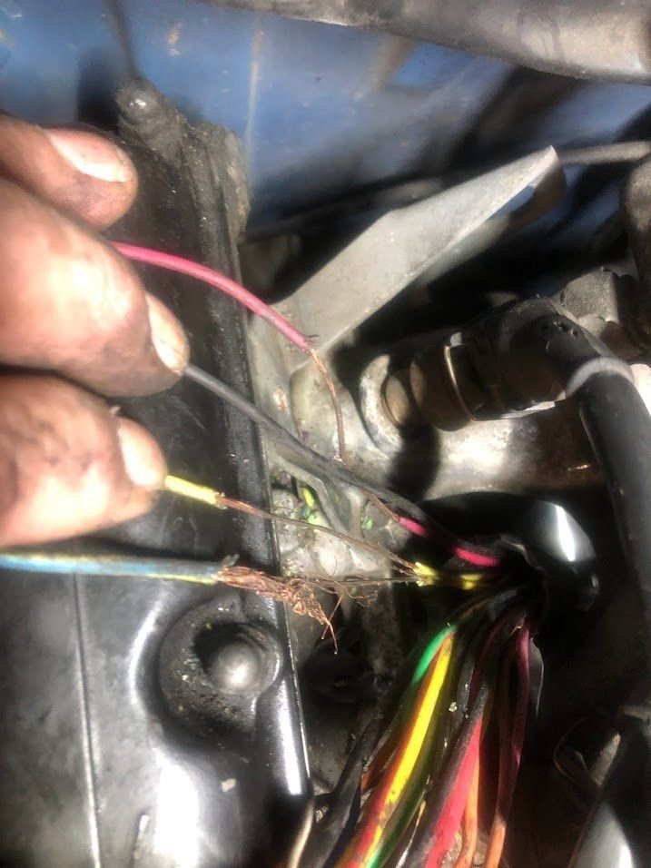

No that wire under the hood near the firewall still goes through the NSS. A guess would still be battery connections, fuse continuity, or if no power to the starter his engine wiring harness might look like another recent poster here.
