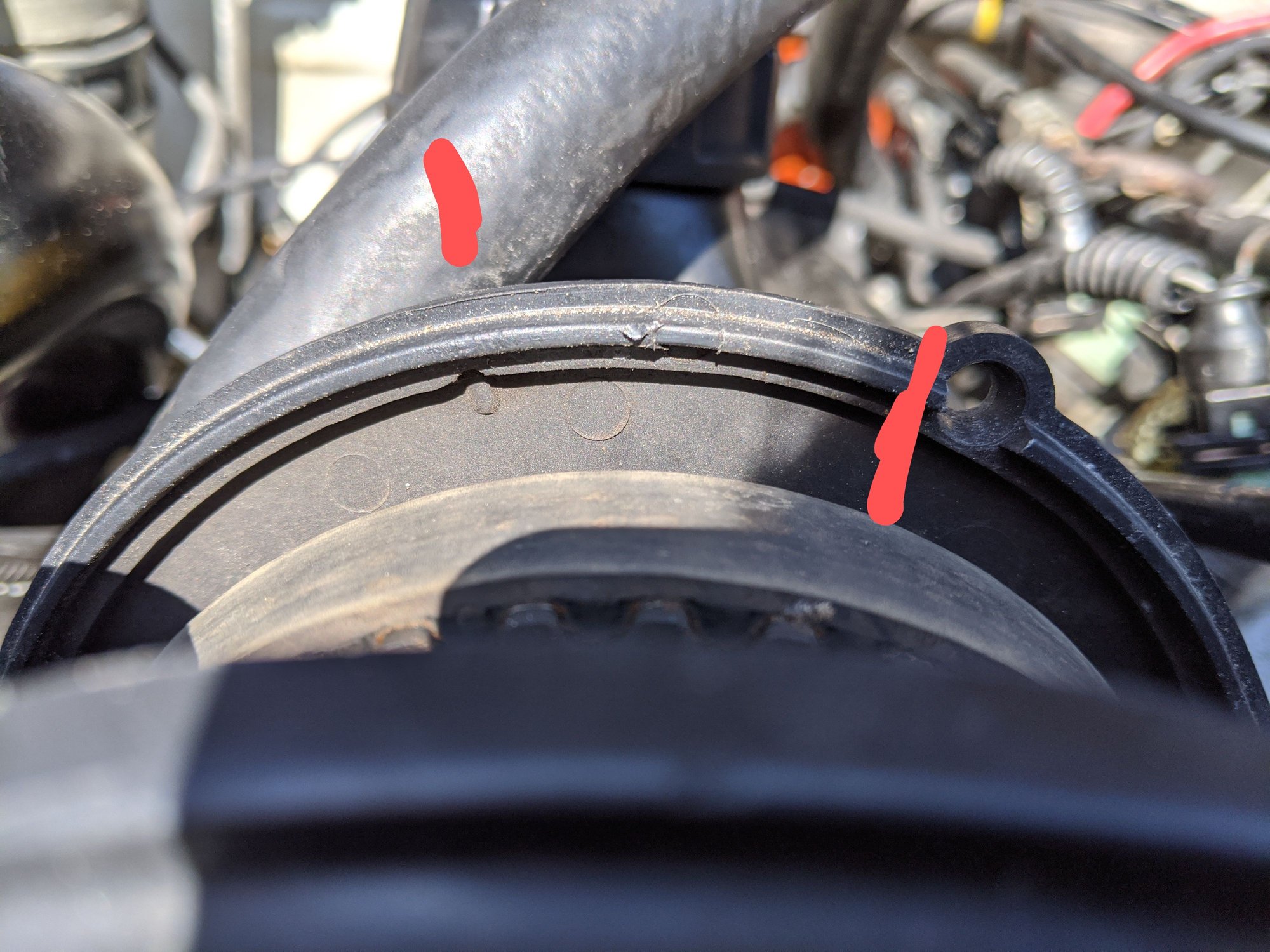

Couldn't resist having a peek so a pulled a few bolts off the cover and here we are:
Looks like I'll be doing a timing belt on this car.
Old May 30, 2020 | 04:54 PM
yeah, phew, that looks like around 35 or 40 degrees late :-O ditto the valve opening/closings...
