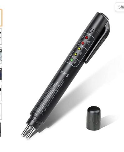

Brake fluid boils at x temperature. Old brake fluid (with moisture in it) boils at lower than x temp. Good maintenance is to flush the hydraulic system every 2 years. If you are curious as to the actual moisture content - a simple tester can be had for $8 from amazon. Glad you were going slowly when the pedal went to the floor!
