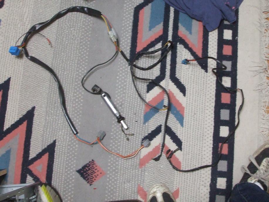

if you're pulling a manual with separate overdrive (eg, M46 rather than an M47 5-speed) do be sure to get the OD control relay that is probably tucked up behind the center console and probably accessible after removing the glovebox, along with whatever of its harness you can extract. in the Snake thread, I detailed the connections. one connector is down on the right side of the transmission hump, the other over towards the instrument panel, and I think it has a wire to the fuse panel.

It's a wagon with a cable speedometer. I'm going to look for all wires related to the overdrive. I was actually wondering where the relay is in this car, so that will help.

the vadis parts list for the 1985 shows a overdrive wiring harness behind the dash, has a wire to the fuse block, a wire to the circular connector behind the instrument panel, the OD relay connector, and wires that go down the right side of the console towards the tranny with 3 total ends?
the greenbook 'locator' drawing shows the harness as having a 2x2 square connector (with yellow and blue wires) on the leg that goes to the instrument panel and fuse panel. And it shows the cables that go down the console, a thinner one from the OD relay connector just goes down to near the AC(?), ahhh, I bet its the ground wire. The fatter cable from the OD relay goes down to the side of the tranny hump near the right side of the center console and has two connectors, one 3-pin (black, yellow, red), and one 1-pin (blue)
there's a second harness at the transmission and shifter that connects the solenoid, gear indicator switch, and the OD pushbutton on the shifter, this plugs into the 3 and 1 pin connectors above (nothing that the 3 pin has a brown wire on the other side connected to the black wire mentioned above)
the relay looks to be shaped like a conventional relay, but the schematic shows it has some logic in it. it has horizontal pin 87 on top middle, vertical blades 31 and 85 on the left and right side, and H pin 86 in the center, and V blade 15 on the bottom middle (this as you're facing the connector end of this relay). ahhh, vadis says its a 'red' relay, and its PN 3523805. I believe i Listed the wire colors to it already, so I won't again.
I hope this isn't all A) too wordy and B) at least somewhat helpful.

I got it the OD relay harness (no relay unfortunately). It plugs into the other wires on the gear shift ****, has a ground and a splice-into-an-existing-plug connection under the instrument cluster.
I've attached pictures below. The gray connectors go under the gauge cluster. You can see the relay plug (blue). There's a ground coming off it. Then the plugs on the other end. They are one 3 contact plug and one single. They go to the shift lever (the magic OD button) and the other two go under the car to the transmission. One goes the the OD solenoid and the other goes the the 4th gear contact on the top of the gearbox. The other harness is the reverse light harness.
There was another harness on the car that connected to fuse 9, but it looked to be just the up shift idiot light control. I would have taken it, but has two wires that run back and disappear near the rear seats. I think it goes to the pickup on the rear diff for selecting shift points. The mech speedo has no way of out putting speed electronically so I think that's how they drive that. It also has two difficult phillips head screws in the steering column for ground that are really hard to loosen. The pedal carrier has some wires to the clutch pedal; I'm going to look at pulling.
