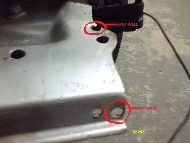

I would use a very small chisel to separate the fender from the pan,the fender lip is only about 1 1/2" under the lip.I have included a pic of the front lip of my 82 242 showing were they are spot welded.Car still has the original paint.
