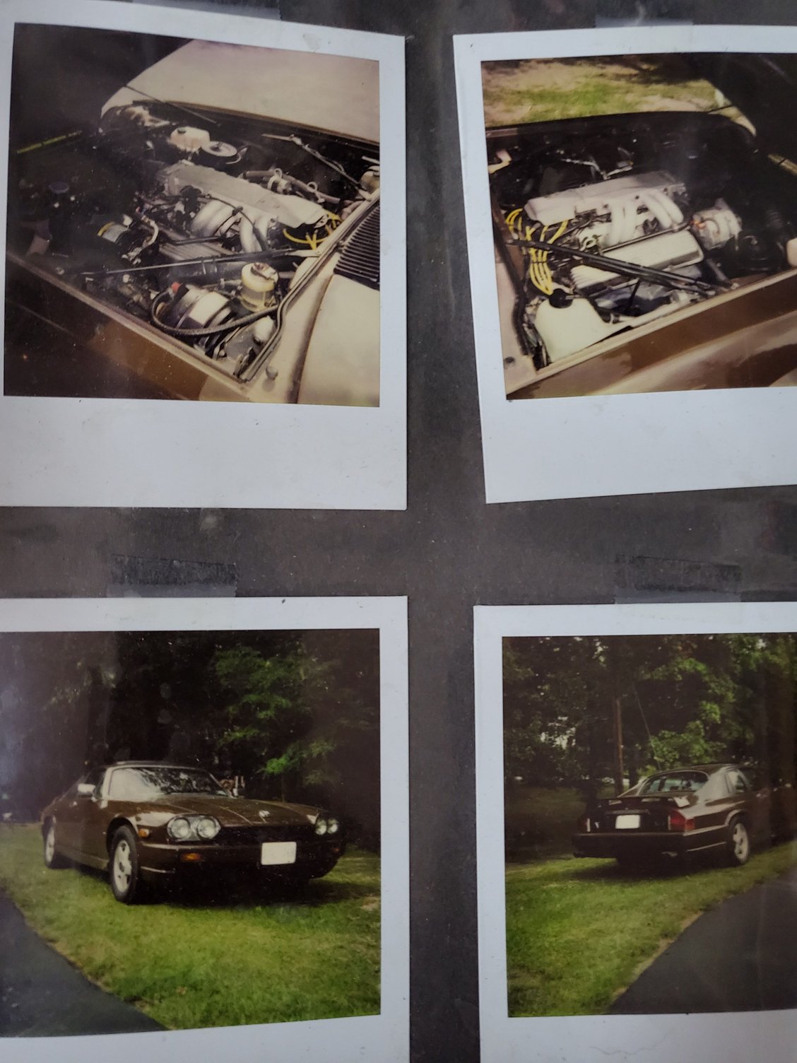

In my youth I've done several V8 conversions . They were all Corvette drive trains in different Jaguar chassis. Those years are over as it's a little to late in life (80) to take on a major project . Just doing a simple OEM swap will only tie up a few days where as a conversion would take a month or 2. My main focus now days is golf and enjoying my C8. I see a lot of 240 short blocks so I'll still look for a 740 but good to know either one will work.
Just one of the conversions on my 100K mile XJS
