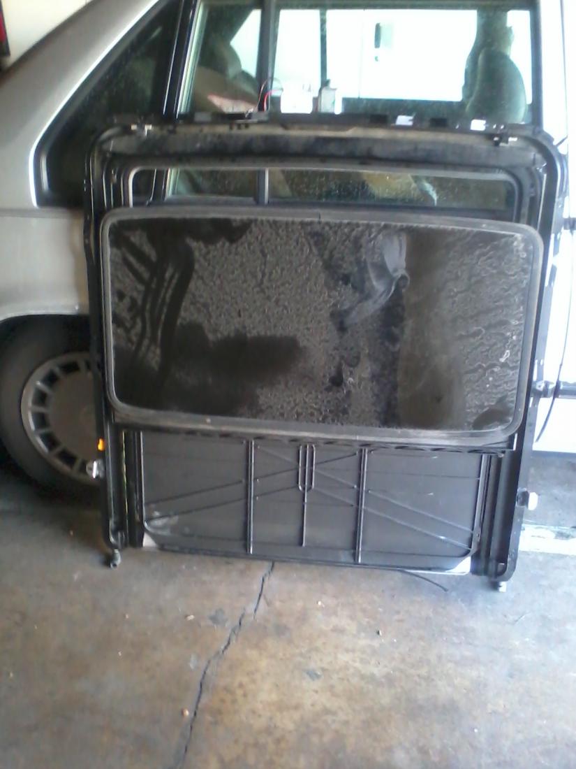

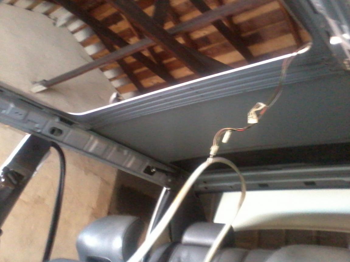

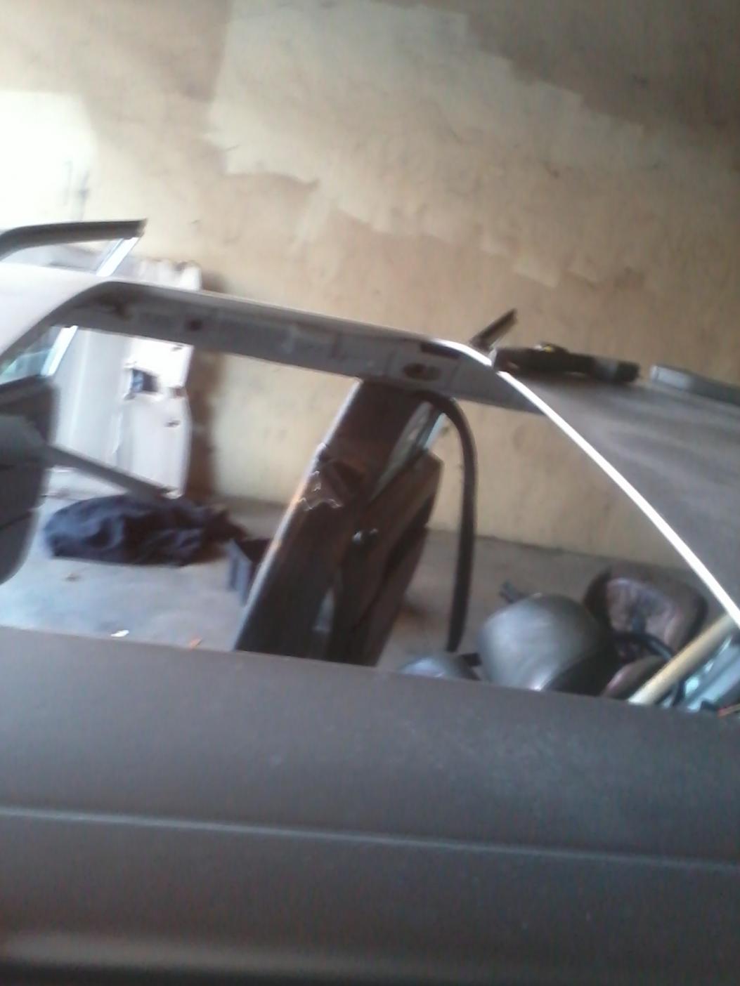

Just a few pics of my s90 sunroof swap. I'm done, just got take pics of the s90 sunroof and interior pillars I added...
1st pic is my og sunroof
2nd pic is outer sunroof out
3rd pic is inner panels and sunroof out
4th pic is s90 sunroof before install
Attached Thumbnails s90 sunroof swap-img_20120102_141746.jpg   s90 sunroof swap-img_20120102_153734.jpg   s90 sunroof swap-img_20120102_153741.jpg   s90 sunroof swap-img_20120102_141737.jpg

Some folks take the S90 glass moon roof and swap it into earlier 940's with standard steel sunroofs. That's what he's done here.

700/900/S90 will interchange just fine. I am not sure about sedan to wagon though... I want to say yes, but...
I have done several swaps but always body style to same body style. Pretty easy in the wagons, not so easy in sedans. In the latter, to get the headliner out, you have to take out at least one of the front seats, the back seat, and even so be really careful maneuvering the shell around--it is fragile and breaks... If you are just doing the sunroof, may be the headliner can stay in the car but I don't recommend it as it will be in the way.
