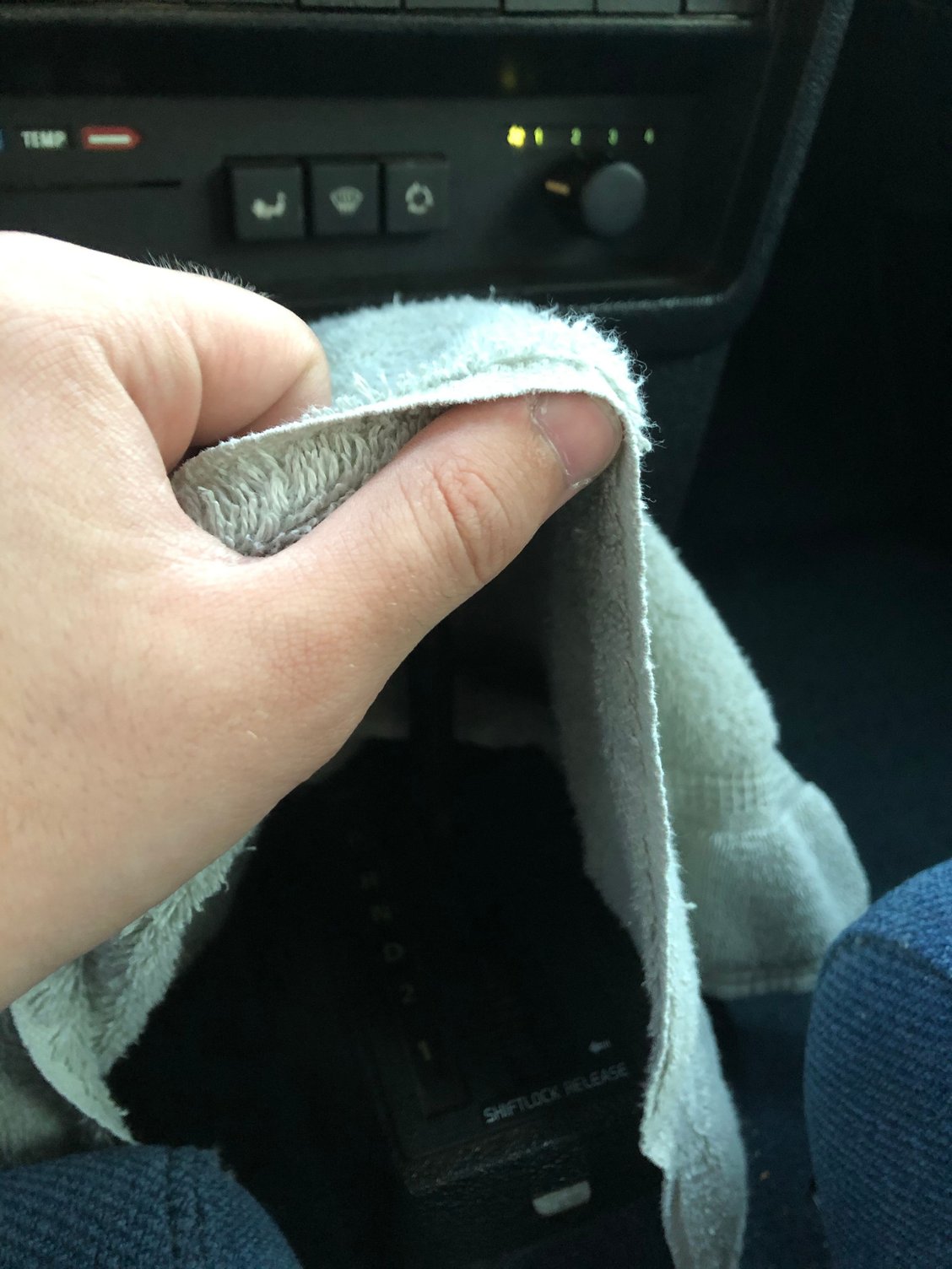

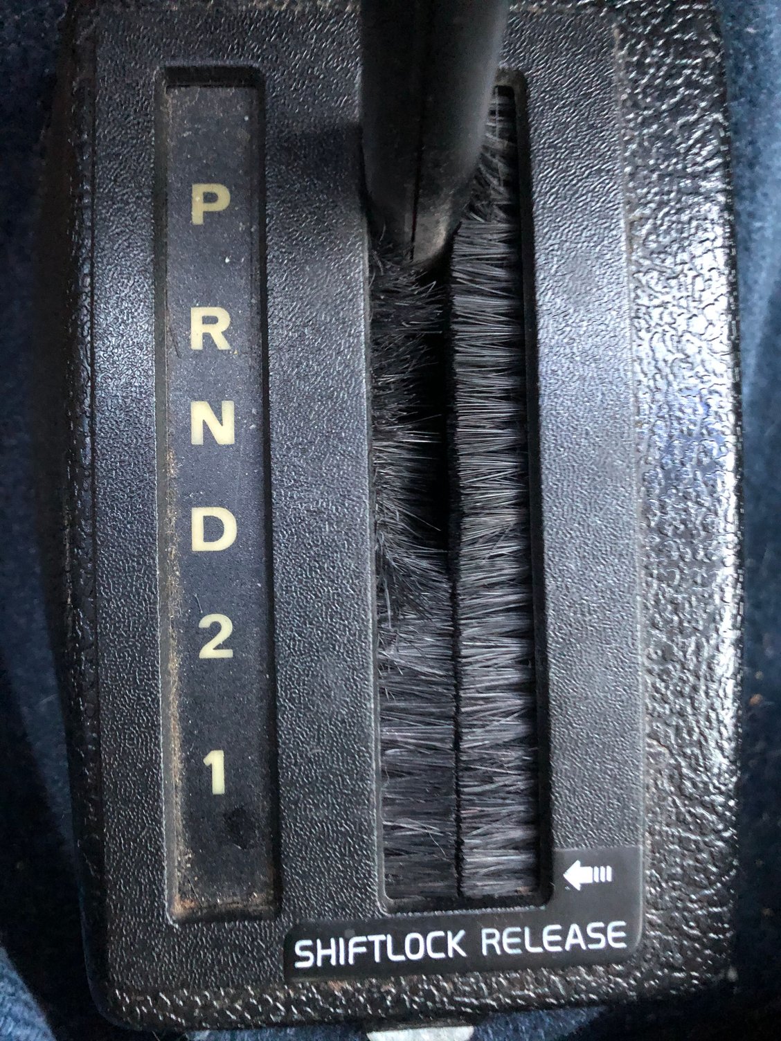

This is my 92 Volvo 240GL. A couple days ago I spilled a drink in the backseat when the door slingshotted the drink out of my hand. It spilled all over the left side backseat floor. I shampooed it all out. And noticed at night my shift lights don’t turn on absolutely nothing. I’ve changed fuses, tried to look for wires but have found nothing. Again the spill was in the left backseat floor and kind of got soaked near the drivers seat seat warmers and other electrical stuff. Help me out the towel is to show the lights not on the fan lights are on showing I turned the lights on, where they should be working but are not. Help me out please I’m begging this car is in mint condition I can’t have this crap. PLEASEEEEEE

Check the bulb. A spill should have shorted out and caused a blown fuse but may be not since you say you checked those. Then again, may be the bulb just burned out unrelated to the spill...
Old Mar 11, 2021 | 12:13 PM
The bulb moves with the shifter - and eventually one of the wires break due to the constant bending
