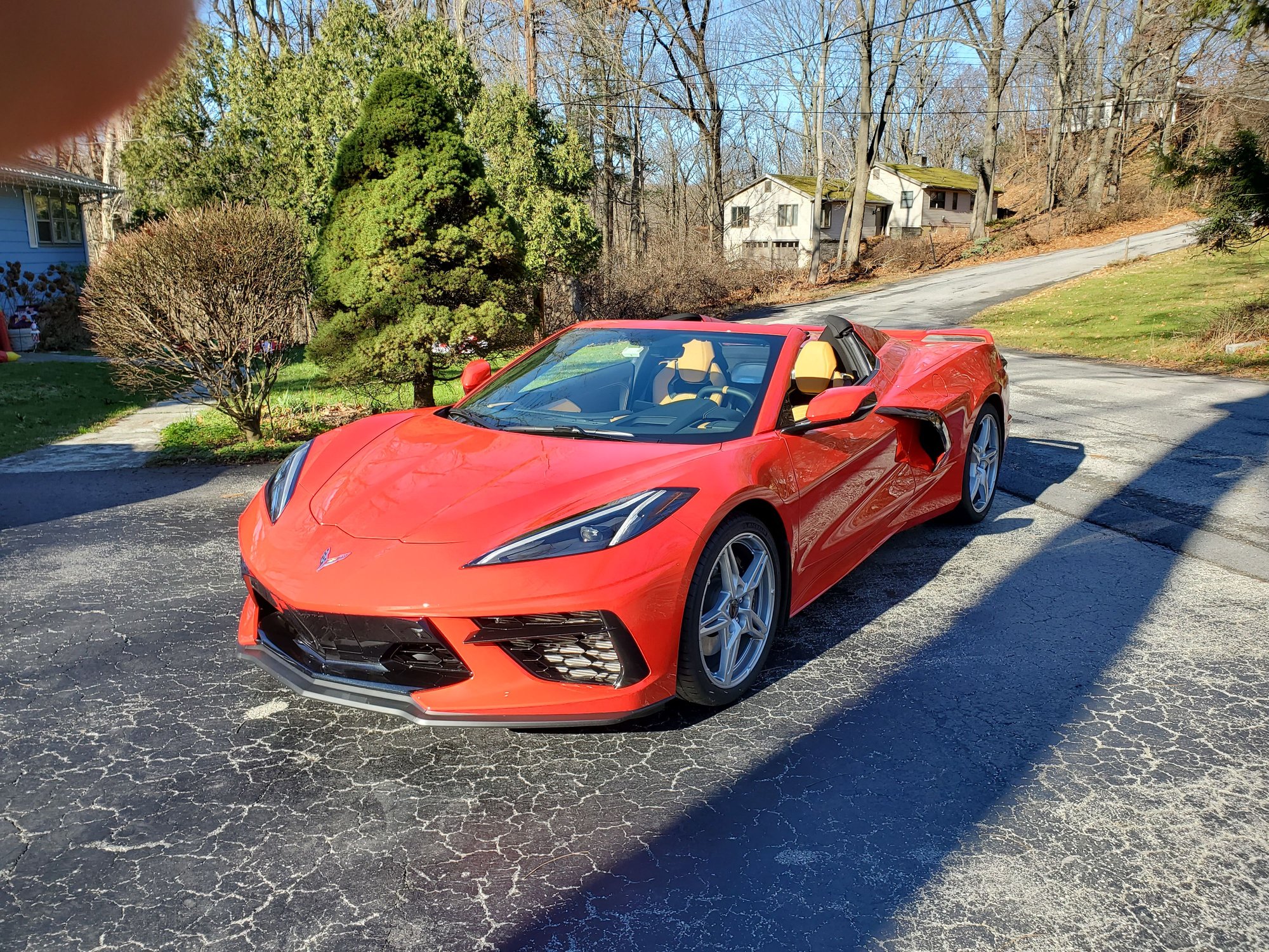

I just picked up my new ride and got a quote for a ceramic coating. Detailer gave me one that is good for 3 years and because my car was new he didn't think the prep would be to bad. The cost quoted was $1600 .
