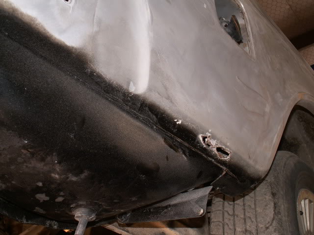

It's a drain, actually. The rubber plug insert has a small opening facing the rear to allow any leaking water to exit. In this pic, you can see I have a hose coming out of the plug at the bottom of the "butt cheek".
