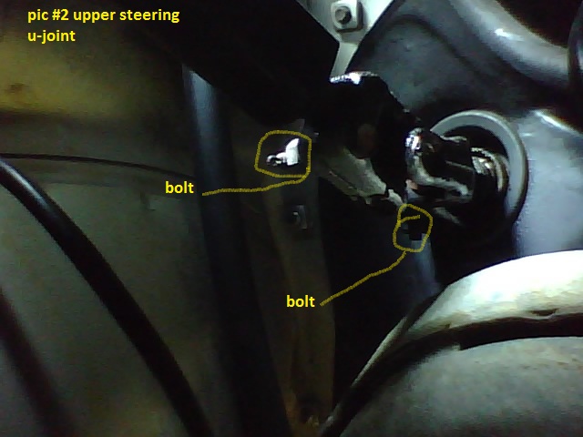

Well they really don't wear out,the little needle bearings in the cups usually get rusty and corroded.The steering shaft is at such a steep angle that two u-joints are required,upper and lower.The lower one is the easiest to remove,loosen and remove the lower and upper bolts.Take a hammer and a punch and peck the u-joint up the steering shaft just enough to remove from the rack assy.Now see if you can rotate the joints up and down and side to side,if they are hard to move they need to be replaced.The one I replaced the other day was so stiff,it couldn't be moved by hand.The only way it would move was by securing it in a vise and peck it with a hammer.I included a couple of pic's that might help you,these were taken with my phone so the pic quality is low.
Edit: I just seen post #3. Did you have your front end aligned after you did this work? A camber issue will cause a slow or no return to center.If your sure your alignment is correct,check your steering u-joints.
Edit: pic #2 is upside down,the round part in the bottom right is the brake booster.
