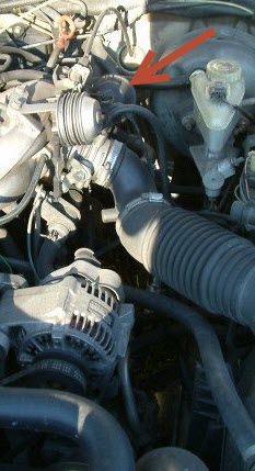

So I heard a rattling grinding noise and opened my hood to find this the rubber washer like thing around the alternator bolt that I have a arrow pointing to in the picture has litterly flaked apart. I need to drive my wife to work tomorrow and then go on a trip Saturday. Is there anyway I can fix this quickly cause I cant order the part it seems. So with that thing broken the alternator has no tension.

those are the alternator suspension bushings.
I believe this is the right part, but you never mentioned your car year/model.
Volvo HD Poly Engine Accessory Mounting Bushing AFTERMARKET 112309 1378153 463909P
and you need like 4 of them for the alternator, the A/C compressor also uses them, I think.

It's a 94 940 and I already found them online but they wont get here in time. I was looking for a temporary fix to hold me over for when they get here basically tomorrow and Saturday.

Figured it out on my own. What I did was wrap duct tape around it to make it thick enough then lube it with oil and force it in. Tension is tight and everything is holding together until I get the parts in.
