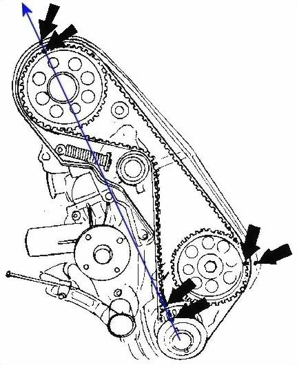

Nobody here can tell me where the rotor is supposed to point when you put on a new timing belt? Could someone please let me know, I just replaced the fuel pump and it still won't start....Thanks!

Once all the marks are lined up, the rotor should be pointing to the #1 spark plug wire.
