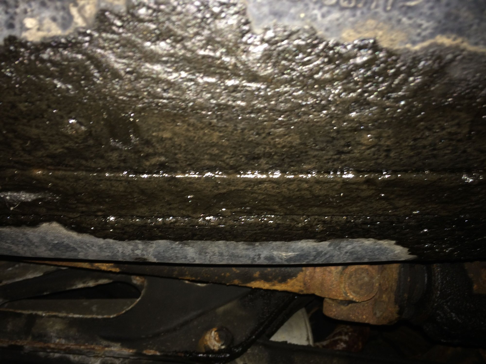

To add gratuitously to this horror show: It seems that this same black goo is oozing from the bottom of the fuel tank...

"Black goo oozing from the bottom of tank"? That would mean a leaky tank... No choice then but to take it out. I've never done that but it doesn't seem that difficult for a car with no rust which is not the case here, unfortunately... Seems like this car sat unused for a long time for the gas to be this bad...

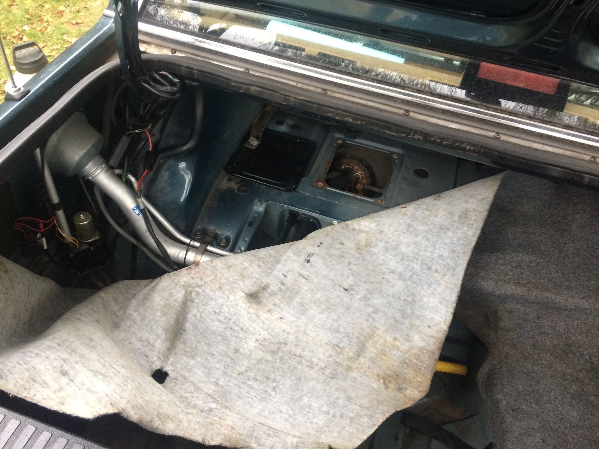

the pump is inside the tank, and accessible only from above, through an opening in the floor behind the back seat. there are no openings on the sides or bottom of the tank, so if you're seeing goo dripping from the tank itself, that suggests the tank has rusted through. OTOH, that goo could be from your differential or something else back there, or it could be dripping around the sides of the tank from the hoses on top.
here's an extensive writeup on Regina tank pump R&R on a 740/940...
ReginaFuelPump

The tanks are plastic, they don't "rust", rarely hear of a leak. The "goo" may be undercoating, oil, some combination but it sounds like the pump will need to come out... PIA if a sedan. On the bright side, with the pump out you can siphon the bad gas out much easier...

Yeah, the pump will have to come out. And yeah, it's a sedan. But that write-up pierce linked to illustrates steps for removing from a sedan, and the author has a couple helpful tips on how to stay relatively comfy even if one is not dwarf-esque...

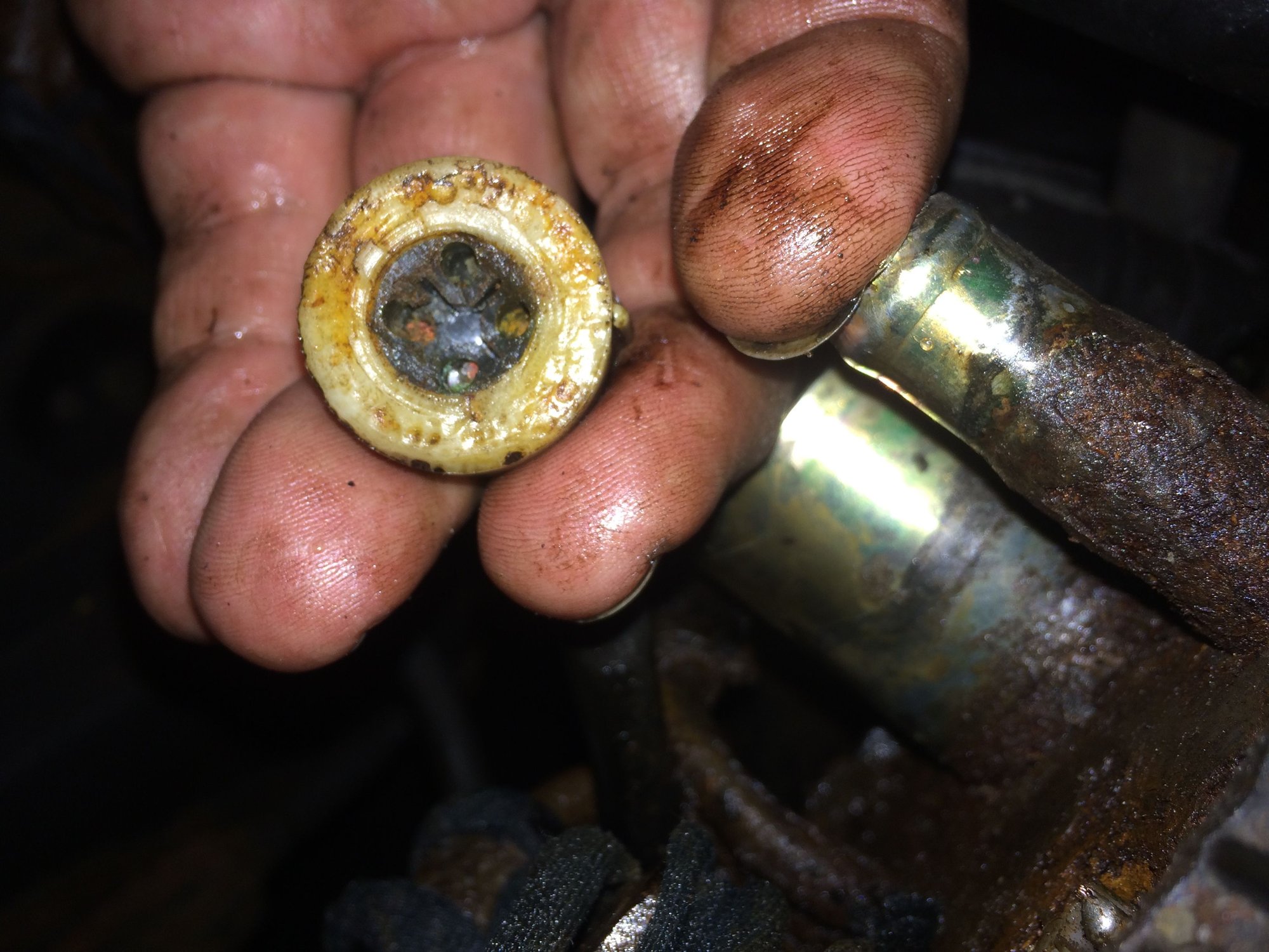

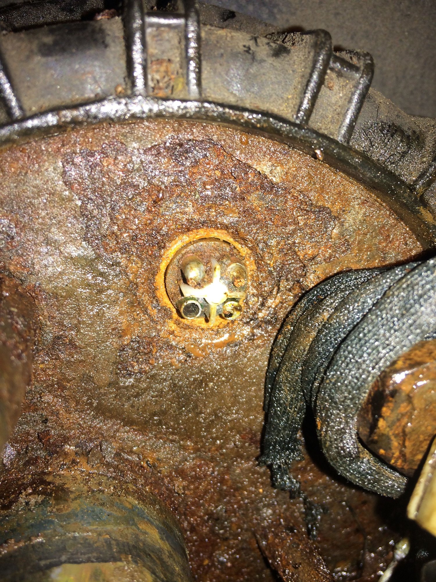

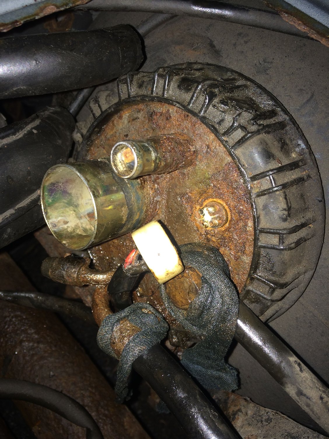

So in fashioning my "B'Laster wraps" for that big banjo bolt connecting that upper hose (fuel outlet?) and for the clamp on the hose below it (fuel return?), I jostled the electrical connection and it just fell right off. As it happens I did abuse that connection a bit in my ignorant beginnings (i.e., gently pulling on it until I thought to myself "I'll bet that's not supposed to come off"). Don't know what I was thinking back then, I'm sure it wasn't intelligent. Maybe that's how the rust got in, or maybe the whole mess is due to that moisture-trap of a trunk (much decaying matter in there when I cleaned it out this morning). Anyway, pretty sure that's where my lethal resistance readings for the path between points (A) and (D) were coming from, as described in previous post. I take it cleaning these contacts is pointless? How FUBAR is this situation?
(FYI, FWIW, left to right on electrical connector: red power wire which connects to pink wire at trunk connector; brown earth; gray wire way down in there which connects to gray-white wire at trunk connector, black wire grounding pump to chassis. Don't know how these correspond to contacts on pump or to points inside the circle I'm holding towards camera; I can figure that out if that would be useful. Also: Battery disconnected throughout this adventure.)

Ouch, that's ugly! I'd try to source a new one of these, I'd hate to fight all that corrosion...
