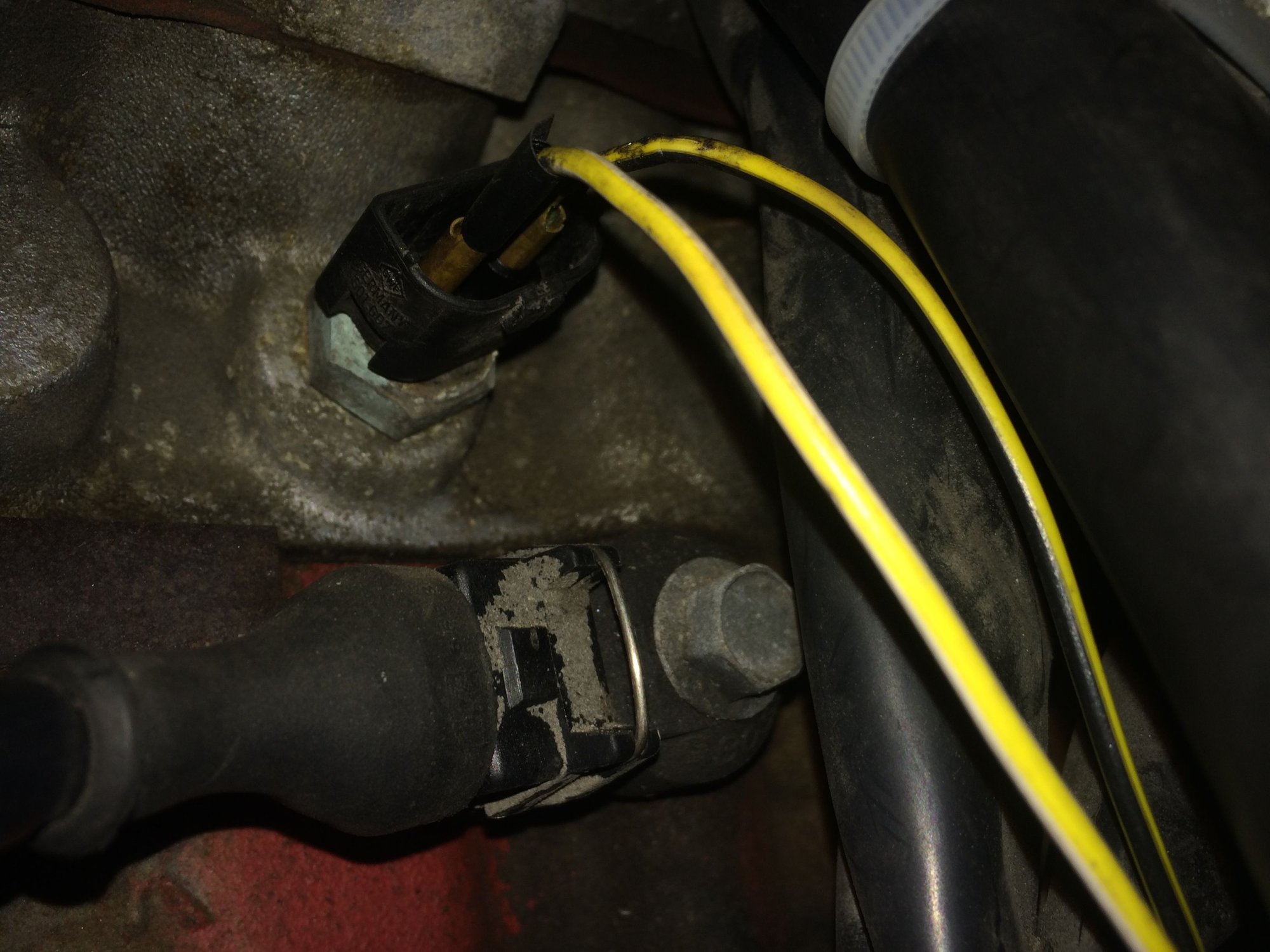

Speaking of my early explorings, they are the reason my gauge temp sensor is currently connected only by those two pigtails (though the contacts are still good). And speaking of jumpers, I read on another thread here that jumping the yellow-black and yellow-white wires is a way to eliminate a possible problem with the wiring to the gauge or with the gauge itself. When I turned the key to ON with those wires jumped the gauge responded, slamming over all the way to the right (much as it is flopped all the way to the left when properly connected up). Wondering how to test the gauge sensor.

i found 240/740/940's cooling to be pretty hard to get airlocked, as long as you crank the heater temp valve on high while you're flushing the system, they always seemed to get the air bubbles out by themselves.

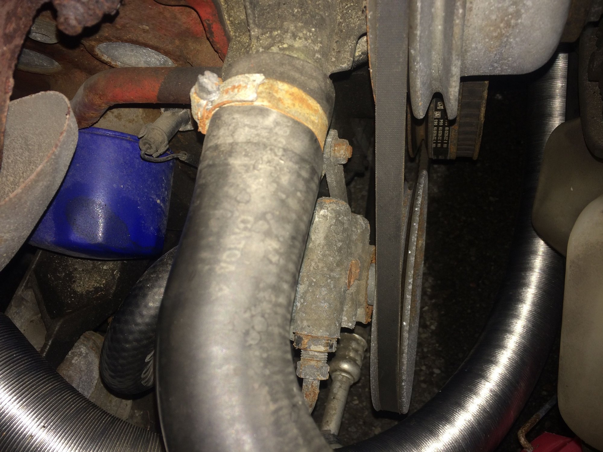

- Engine getting plenty hot. Top and bottom rad hoses, plus hoses to and from (what I think is) heater valve (pictured?) also hot. But unless I’m revving engine, heat from heater is tepid (though I'm not that familiar with how typically hot this heater runs; I've only lately adopted this car). If valve were stuck (doesn’t look unplugged) how to test/restore it?

that heater valve looks /very/ corroded. I would replace it with a new of of the updated style...

Heater valve only lets water in the heater. And, yes, if it's not opening it's not letting water in the heater core. The valve should be changed, then flush and refill making sure no air pockets develop. The gauge seems to be trying to come to life, get circulation first. i am not sure about the testing for that. What RPM are you having now?
That second heater valve is a generic one widely used, available at parts stores, you don't have to buy on line and wait...

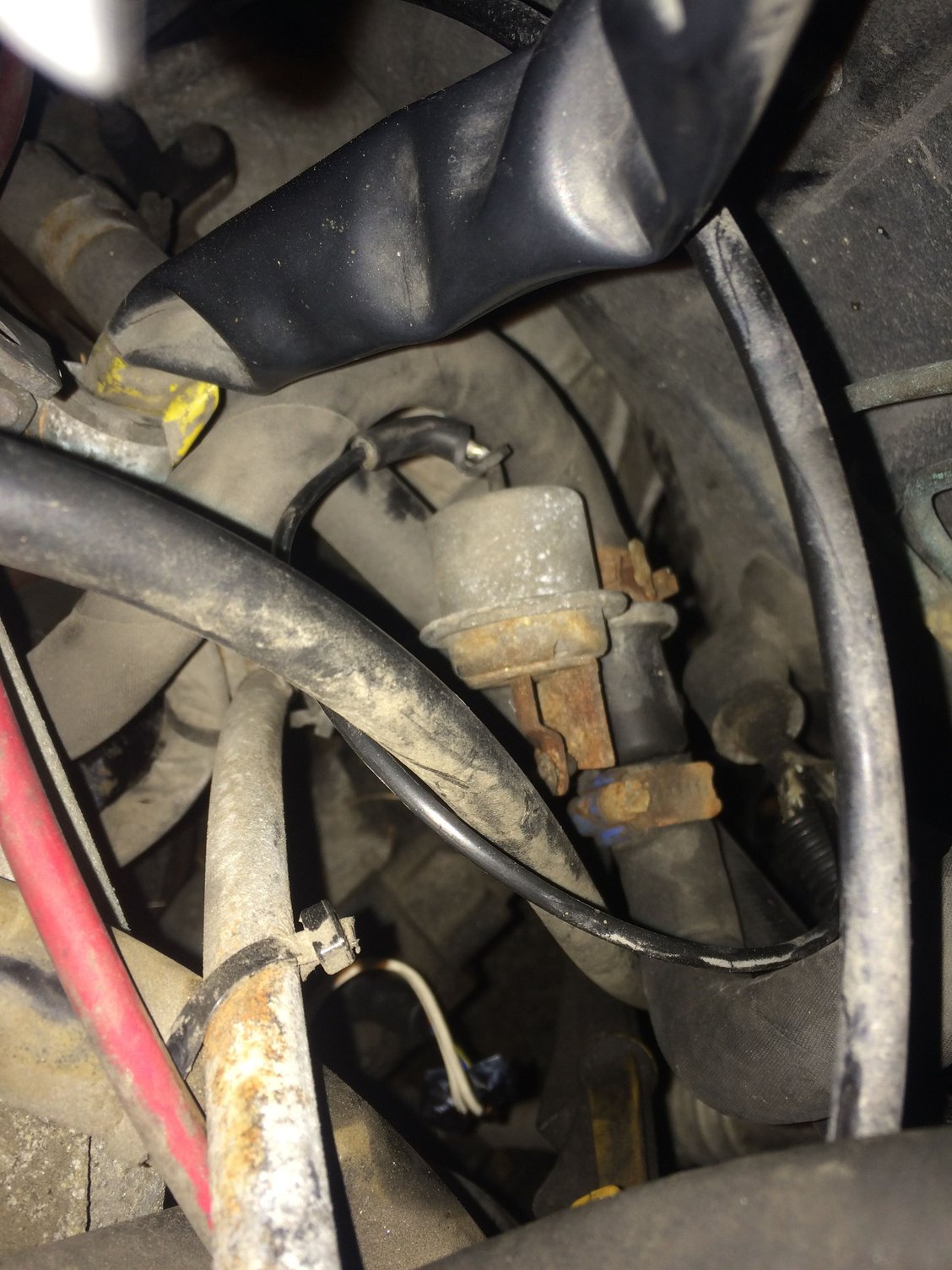

Glad it's not a must lol, because I'm a little unclear what a "petcock" is (a drain plug?) or where it is on my car; is it something in the attached pic (you said it's on the engine, passenger side)? When I do find it, any best practices/tools for removing it? (Am I overthinking yet? )

Yes, a drain plug basically, it's under the exhaust manifold toward the back of the motor but leave it alone for now, address the basics first. Not sure about the size but it's not that hard to get to on Non turbo cars.

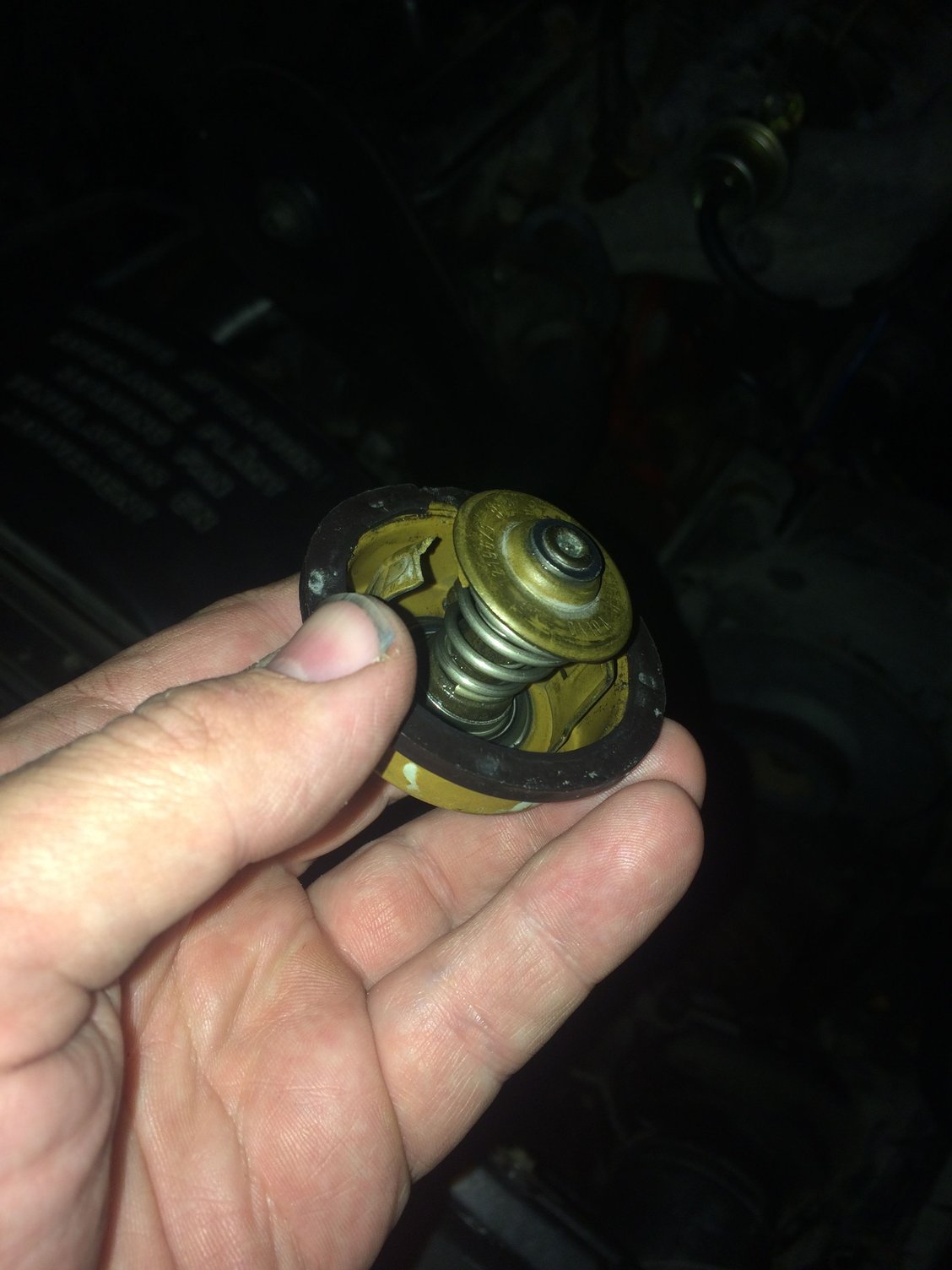

So first thing was to replace the heater valve. Vacuum felt a lot stronger. Tried the heater. Still not hot (unless revving). Went back under the hood, felt the hoses. Noticed top rad hose much hotter than lower rad hose. Remember another thread in which someone (pierce?) said that if that's the case, your thermostat is busted. Pulled it. Yes it was. The breakage looks like it kept the (temperature-responsive?) valve closed so there was my circulation problem? (Not bailing on the flush, though.) Ordered OEM replacement, coming in tomorrow at AutoZone. Also remembered another poster on another thread (Lev?) recommending running without thermostat to see if that was the problem. Ran it without thermostat (was sure to burp as I gradually topped off); top and bottom hoses became evenly hot. Idle also seemed to improve. Gauge still dead, but that's measuring coolant temp of course, and coolant can't heat up without thermostat restricting flow, right? Educate away. And again thanks.
