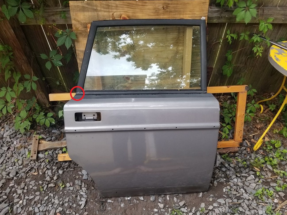

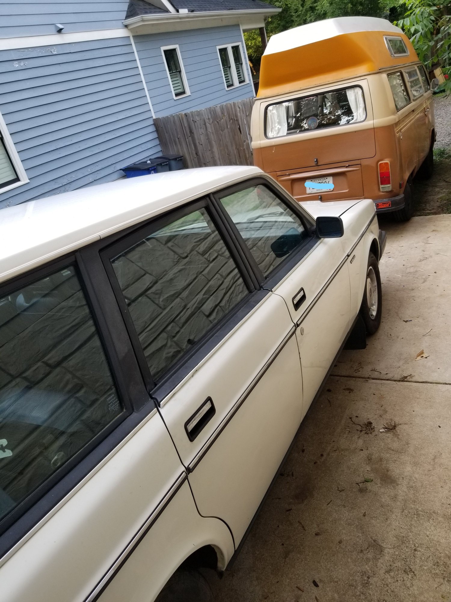

My current door on my 245 was bent and did not close properly so I went to the junkyard and got a door from another car. the only difference is the top trim right under the window how do you remove this.
the original door is from an1985 245.
Attached Thumbnails Under Window Trim Removal-20180526_173243.jpg   Under Window Trim Removal-20180526_173233.jpg

The trim on the donor door is removed by bending the rear most section of the trim that kinda wraps around the vertical door post. You bend this wrapped around piece so it is parallel with the rest of the trim. Once you have done this use a plastic trim tool to pry up on the trim and release the metal clips that hold it on. I just did this on all 4 doors on my wagon to replace the rubber window wiper seals.
Attached Thumbnails Under Window Trim Removal-20180526_173243_9f54e278ad9ee0240f7f8ac37d9c86d6defdeee2.jpg

a closeup picture of the back end of the new door might be helpful, where this trim piece meets the door, from a 3/4 reverse angle...

oh I got the old and new mixed up... the grey door is from the 1990 donor car, and the beige one is your 1985 ?
yeah, Vadis shows it changed after MY 1985 to the newer painted style. the older style, the weather strip appears to be part of that molding. no clue in the parts diagram how its held on. still betting on double sided tape.
