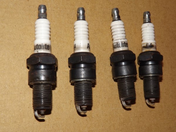

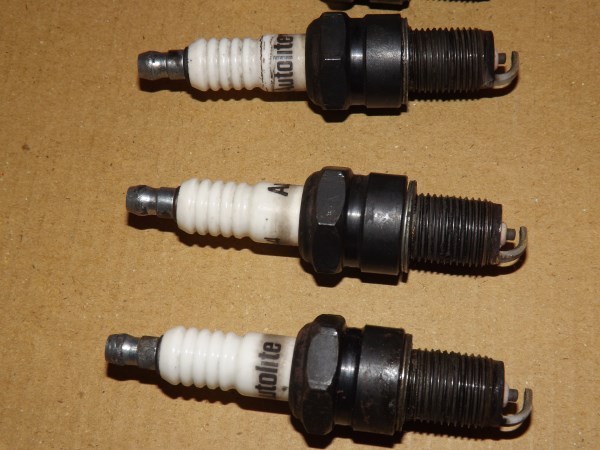

EDIT: Here are 2 photos of the spark plugs I pulled. These are not the greatest images. It's dark here at the moment so what I'll do is take better pics in the light tomorrow and I'll have a video posted as well of the engine noise.

Spark plugs can never quiet an engine, may be if there's blowbye...
Should try to clean the treads, may be put some oil on the treads to make them go in better.
Hard to opine on your noises but these motors are not the quietest. Autolites don't work well in Volvos.

Michael9898: It is odd that the Autolite came out with no problem and no visible damage to treads but one of the new plugs has a hard time going in! I'd think some debris might be causing the issue and might have already done some damage to the treads in the head. I'd tap that whole, at least make sure it's clean and use oil to get the plug to sit in right.
