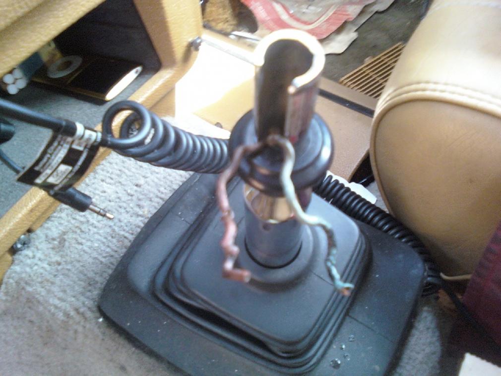

Here is a pic of what I am working with on my shift ****...Where are these two wires suppose to plug into?

I can only imagine those are meant to be attatched to the switch that controls the overdrive, I can't think of any other reason for there to be wires sticking out of the shift ****. I think you'll need a new one of those. If you find a new shift **** with a switch you might not be out of the woods yet, the overdrive doesn't always work on these old cars.

Yeah when I went for a drive later I touched the wires together in 4th gear and it activated my overdrive. So I'm assuming I need a new shifter and new button and I should be able to hook it back up?

yup... that will do it! You're one of the lucky ones whose overdrive actually works okay. Tip: get a replacement shifter from a salvage yard, but get a new overdrive button... I believe FCPGroton sells them, (fcpgroton.com) or IPD (ipdusa.com) Both of these companies are great sources for Volvo parts. Oh,, and don't really worry about the overdrive unit itself... when they have problems, its almost always something to do with the control system- either the button, the relay, wiring, or solenoid. Good luck!
