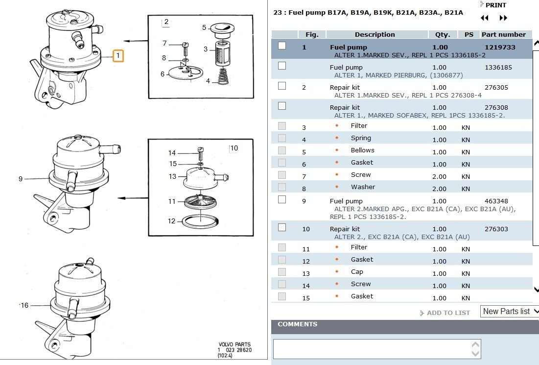

If you have a b21 with a carburetor - (a B21A engine)
You have a mechanical fuel pump mounted on the left side of the engine block. Should look like one of those below. Some fuel pumps come apart and the filter screen can be cleaned. You won't get fuel to the carb - until the engine spins over and pumps it -
Electric high pressure fuel pumps are used with the fuel injected cars. A carb needs less than 5 psi so mechanical works fine.

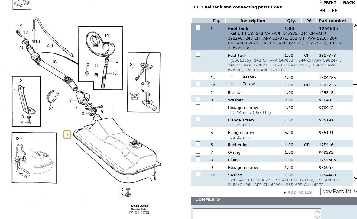

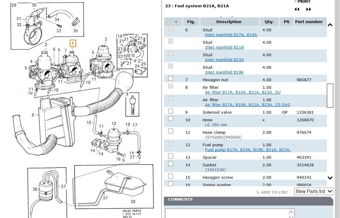

No electric fuel pump in the original system. Mechanical pump can easily suck fuel from the tank. Fuel system is shown in bottom parts page above. No feeder pump as part of the sending unit in the gas tank, (they put out about 15 PSI, too much for a carb) and no electric main fuel pump under the lf seat on a carb car.

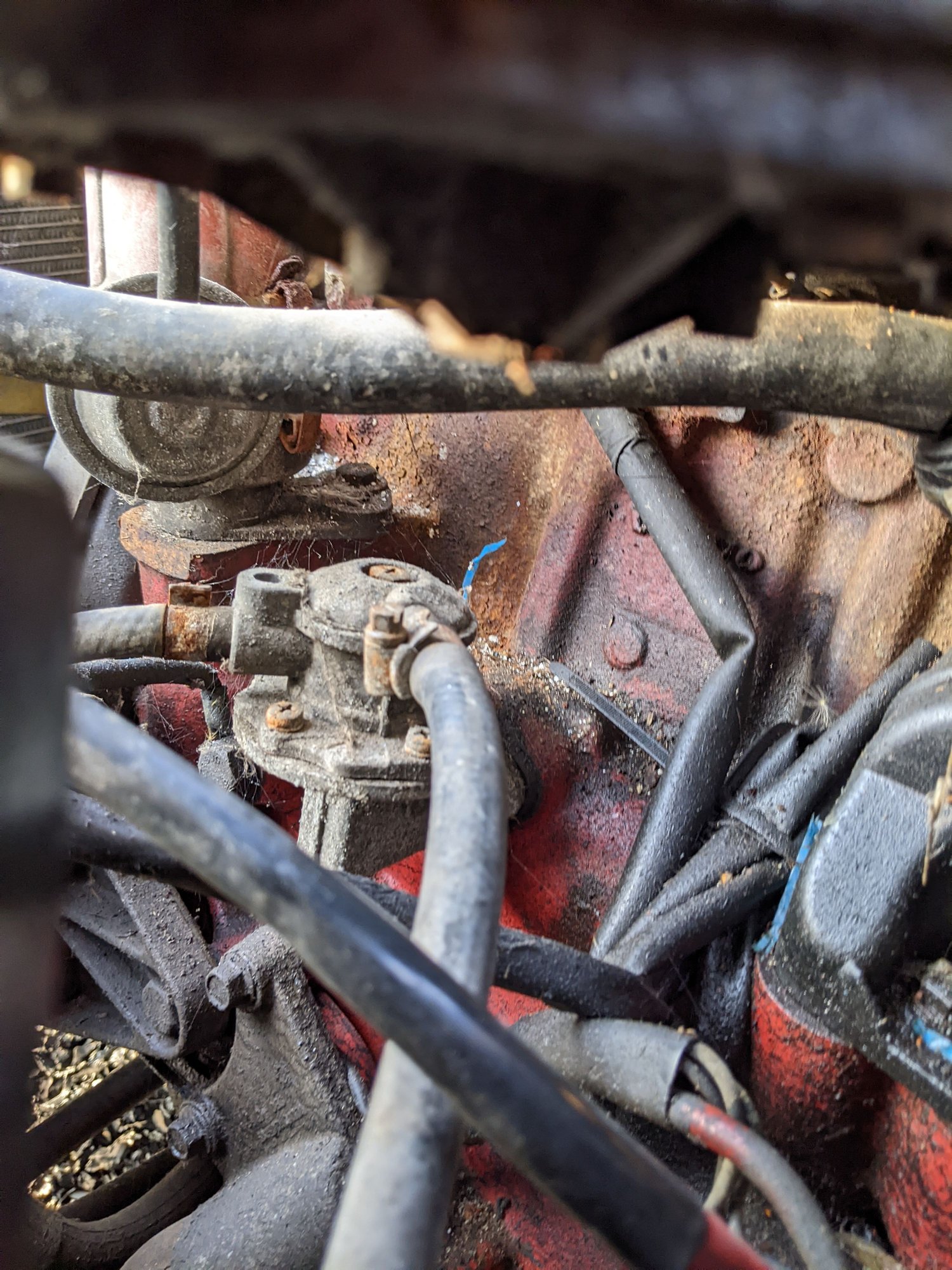

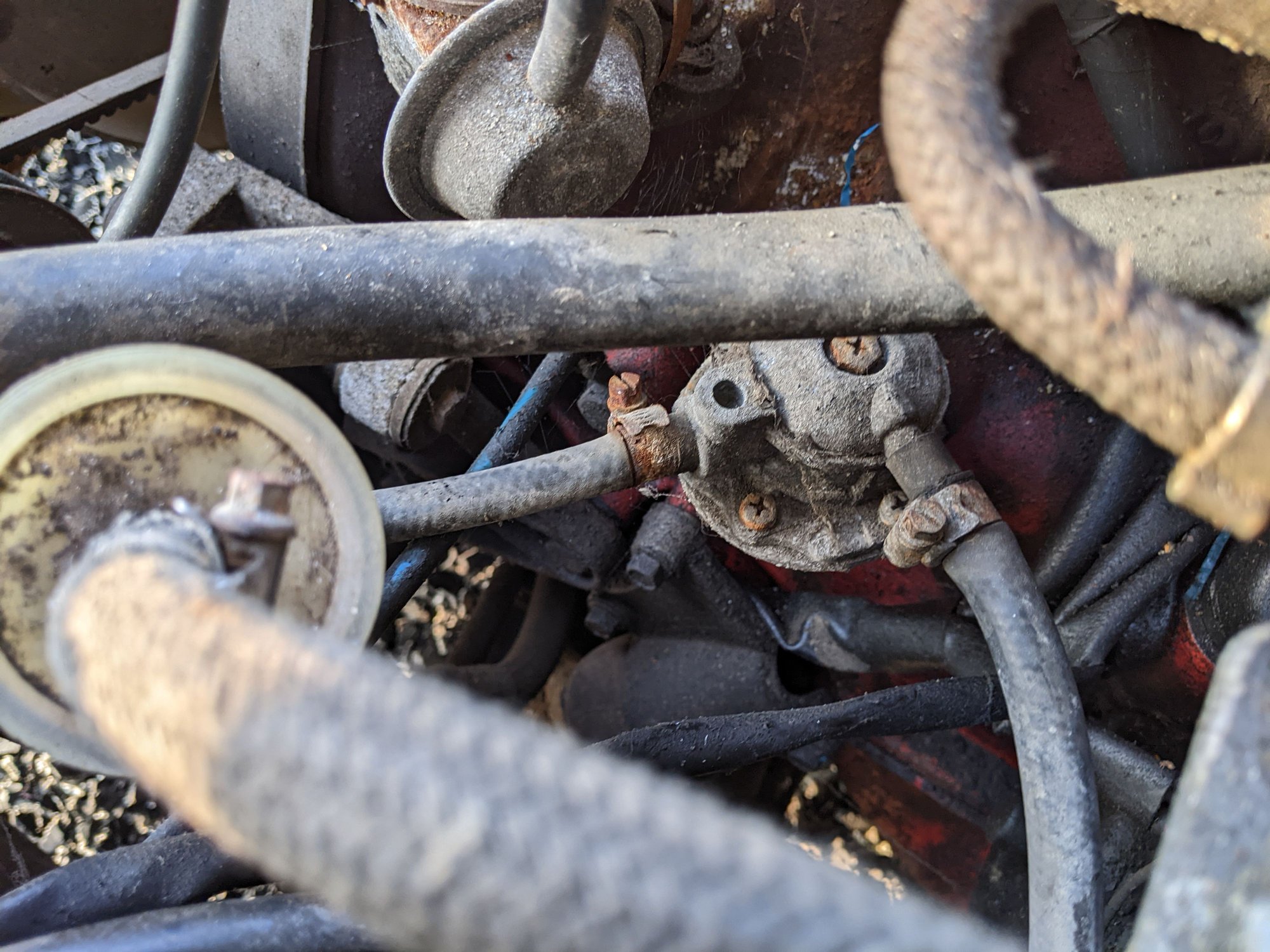

I'm sure my mechanical fuel pump is bad
I will attach some images I took of it, as from those diagrams I can't tell which one mine should have, could you please help me find the part number so I can get another?
Sorry the aren't the best angles but I didn't have much room to work with

Take the pump off, attach. A hose on the intake and submerge in a container of fuel. Manually pump the lever on the pimp to verify it’s actually bad. The cam lobe could be worn off. Then if the pump is bad, source a replacement. Can’t help you you with the part number
