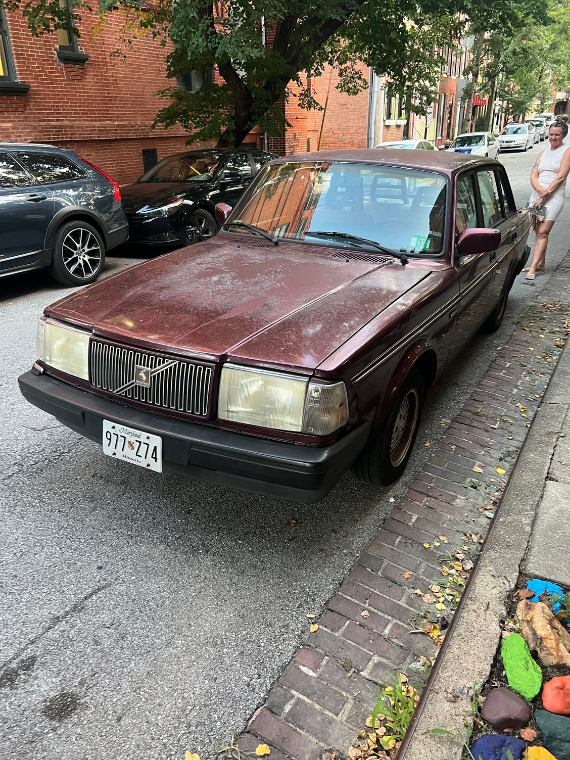

I recently purchased a cheap 1993 Volvo 240 with a leaky automatic transmission as a little project. I’m looking to do a manual swap as I’d like to address the transmission first and want it to be manual. I’m deciding between using the m47 or the t5. I’ve heard the m47s are fragile, cant handle much more power, and don’t feel as nice but would obviously be easier than the t5. I’d like to turbo the car eventually thats where the concern of not handling more power comes in. Any advice on which one is a better choice in your guy’s opinion would be great, thank you!

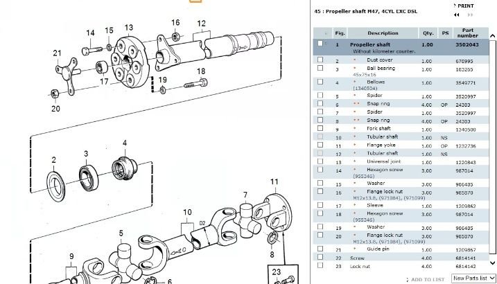

If this is a toy and your goal is to find and install everything needed for a manual transmission. You might want to find the m47 compatible driveshaft first before buying anything else - other 240s have 3 ujoints - the m47 has that flexible coupler against the trans. You'll need a flywheel from a 1989+ car - that can talk to your engine speed sensor also. (there were not many manual trans cars sold in the US during that time period 89-93)
