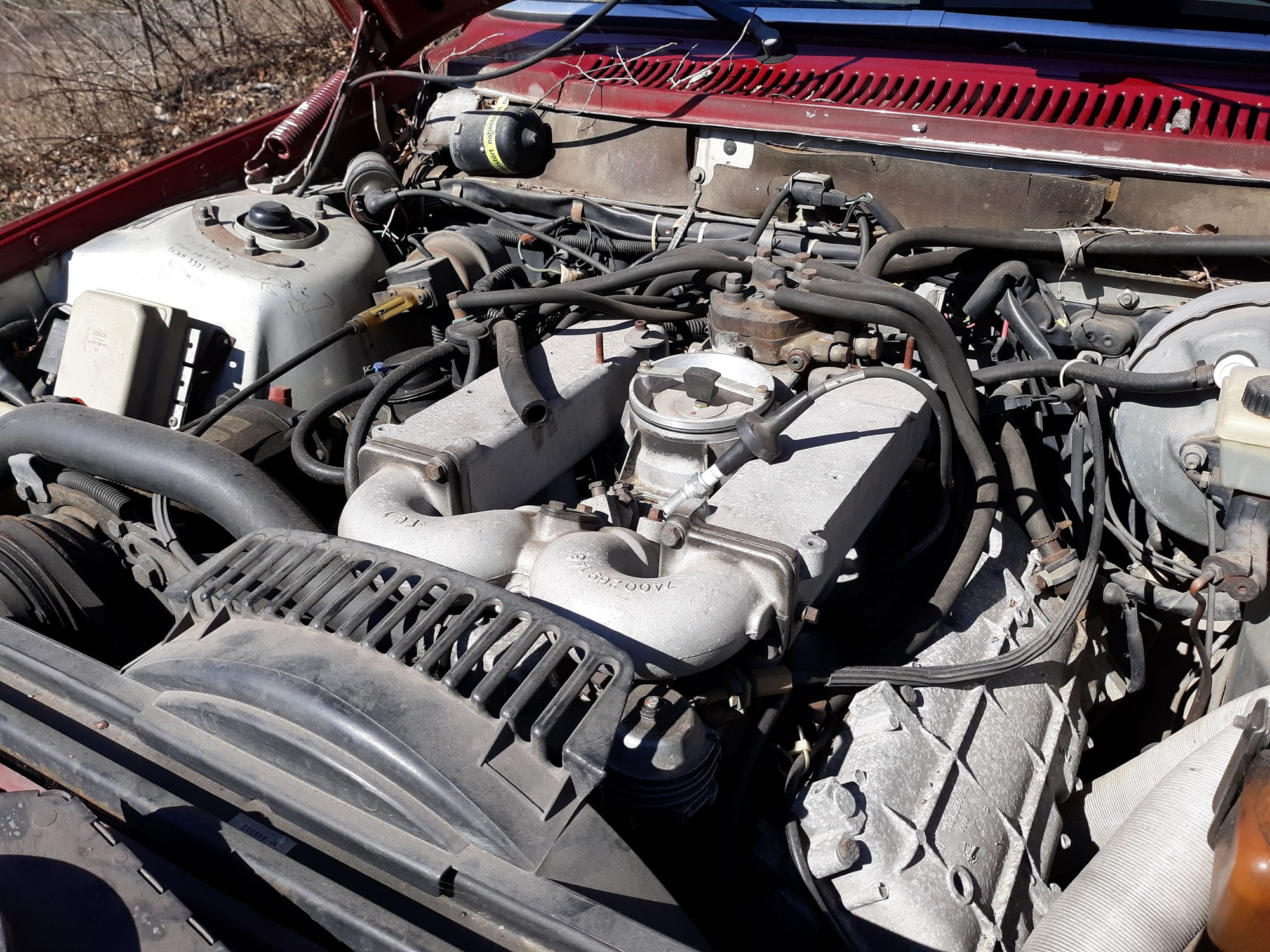

And a picture of the engine:
V6
When I first opened up the hood I thought that surely someone must have put some sort of aftermarket engine in. It looks so modern and well...cheap. It's hard to believe that this in a Volvo from 1980. I think that the person who owned this originally must have been pretty fastidious in maintenance though; everything looks to be in very good condition no signs of abuse. It looks like the car was originally silver so maybe some body work was done somewhere. The underneath is completely rust free and just a few signs of rust in the wheel well. (This is Pennsylvania and everything eventually rusts.) The 164 did have an inline six and I thought that it was an awesome engine. I've read accounts of the 164 being a lemon, but I thought that ours was awesome. Since the engine seems to be so well taken care I think that I might spend a lot more time trying to get it running. I've read that the engines worked well as long as the oil was changed frequently. I think that this car might have been well maintained.
The fuel injection says Bosch and doesn't look familiar to me (The control box is the grey box located on the strut tower). The transmission is a 4 speed manual with an overdrive switch.

This is the PRV (Peugeot/Renault/Volvo) joint venture motor which was supposed to be used in the 760 Volvos, hoped to be better than the BF230 engine. But the PRV was a dud all around and never caught on, Deloreans used it, and so Volvo went with the B230 turbo charged which was much better both power wise and reliability. These PRVs are very undesirable and hardly seen anywhere anymore... many problems.
