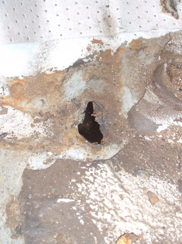

The car's been garage kept for most of it's life, so I wasn't surprised to find that they all drain fine. I may pull the front cowl (in front of the windshield, and check for drains), but I found what my be the culprit:
I have a hole in the floor. It was covered in rusty metal, but now I can see that it probably wasn't sealing anymore. An drive in the rain and water would get thrown up by the wheel. It probably started as a rock chip. If only 700's came with mudflaps. I may have to invest in some.
So now I'm going to weld in a patch. The Volvo green books say to "disconnect control unit when carrying out welding repairs." Who here thinks that's important? Who here thinks I should pull them out? And who thinks what that includes: Fuel, Ignition, radio, SRS, ABS, SOS, CQD, and anything else?
As another note, I talked to some people who sold POR-15, for my rust prevention. They actually recommended Zero Rust over POR-15. They guy said that Zero Rust is pretty new and it does not require the metal prep that POR-15 does. It's in the paint itself. He said just knock off the flaky rust and it goes over it. One quart of Rust Zero was cheaper than one pint of POR-15. Plus you would still have to get the prep stuff. So the guy said he and people who are restoring cars favor the Rust Zero. It's UV sensitive just like POR-15, but under the carpet, it should never have any problems.

Hey, they did sell mud flaps for pre 90 740's...they're very rare...weren't too popular in the States. I'll have to try the Rust Zero...wonder if it's any better than Rust-O-Leum? I used quite a bit of POR-15 on my 144. I didn't use any sort of rust prep compound. I just wire wheeled and bead blasted. Seems to be holding up fine. Can't believe POR-15 would need a prep chemical...that stuff is impossible to get off your skin! I used that stuff two years ago on Valentine's Day...totally forgot I was taking the wife out to dinner at a high end restaurant that night. My hands were in foul shape!

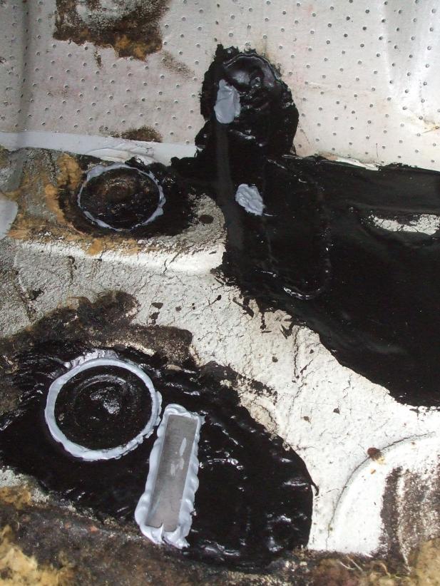

So now I'm done with the floor!
I cut back to good solid metal and welded in small patches (I got the metal from a computer case). In two places I left it open. These are because they are inside the frame runners that go forward from the firewall to the bumper and I need to paint them up the seal them. After the welding, I wire brushed the floor a little more and painted 'Zero Rust' with a brush over all bare metal and rusty spots. This stuff is supposed to use any moisture also as catalyst and seal out all the air while chemically digging into the rust. It's like POR-15. So far, it looks good. After it dried, replaced all the plugs I pulled out for painting access and also plugged the holes I left into the runners. On place I use a chunk of stainless steel to make a plug. Then I filled any other places that I dug out the sealant, back up with new sealant. Tomorrow I think I'll put down the carpet and start the car for the first time in about 3 weeks. Now I can finally go buy food.
