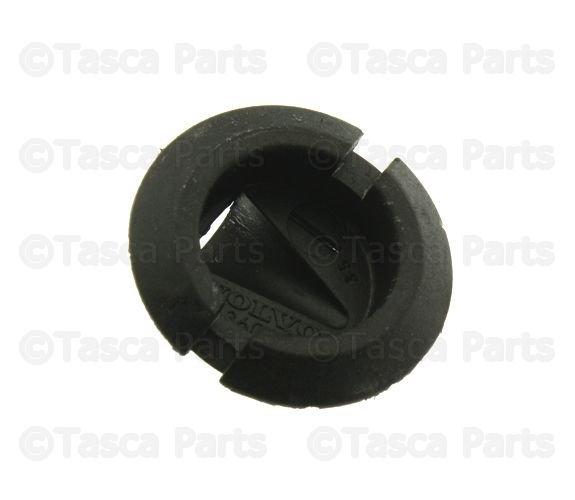

there should be rubber plugs in those holes that have a sort of half moon drain vent that points backwards, so road water from the rear wheels doesn't blow up into the compartments. I forget where the sunroof rear drain tubes terminate on a 740 wagon, I sold mine a few years ago.
ah, this plug here, I believe.... they are oriented so the opening is on the bottom and points to the rear of the car, that way the wind of driving creates some suction.
https://www.tascaparts.com/oem-parts/volvo-plug-1360872

ah okay, thank you.

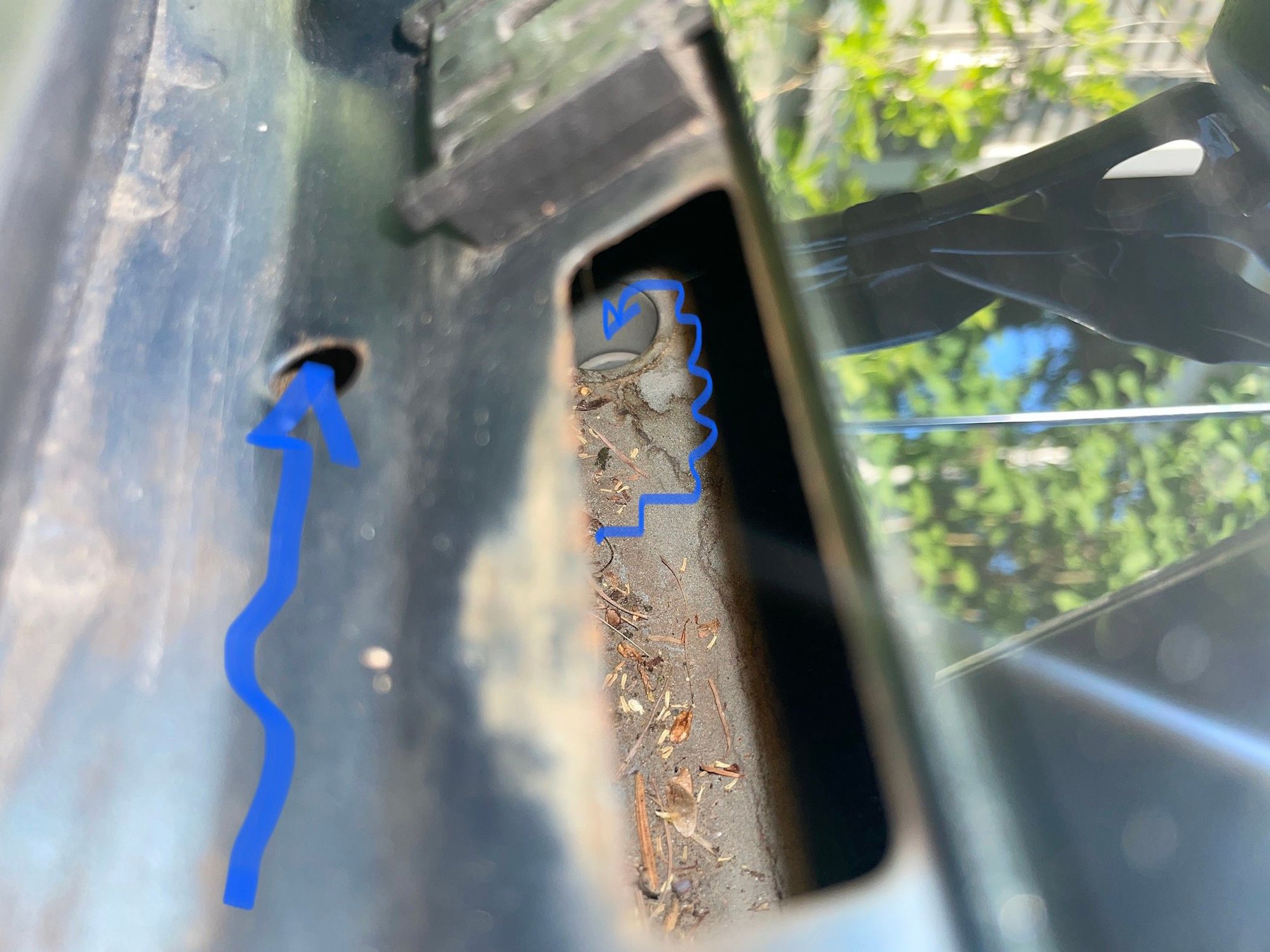

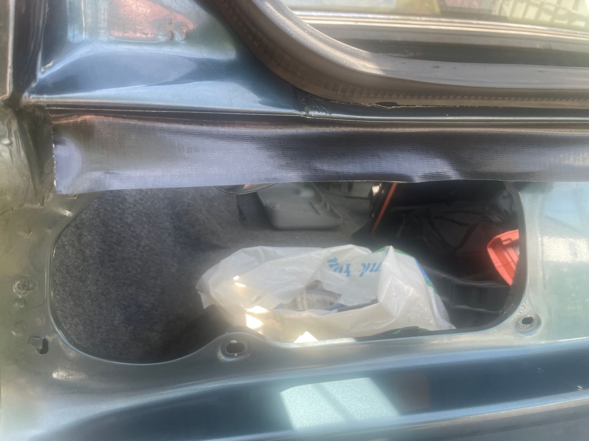

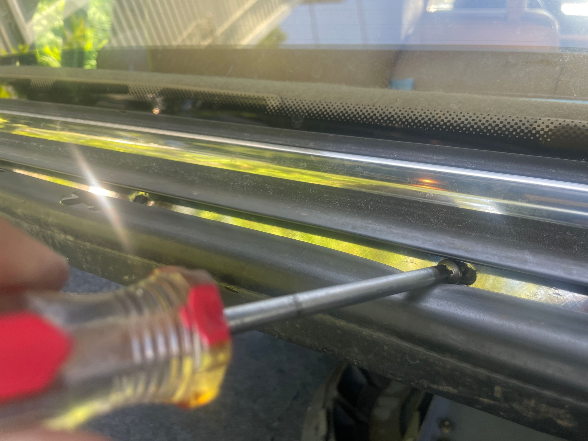

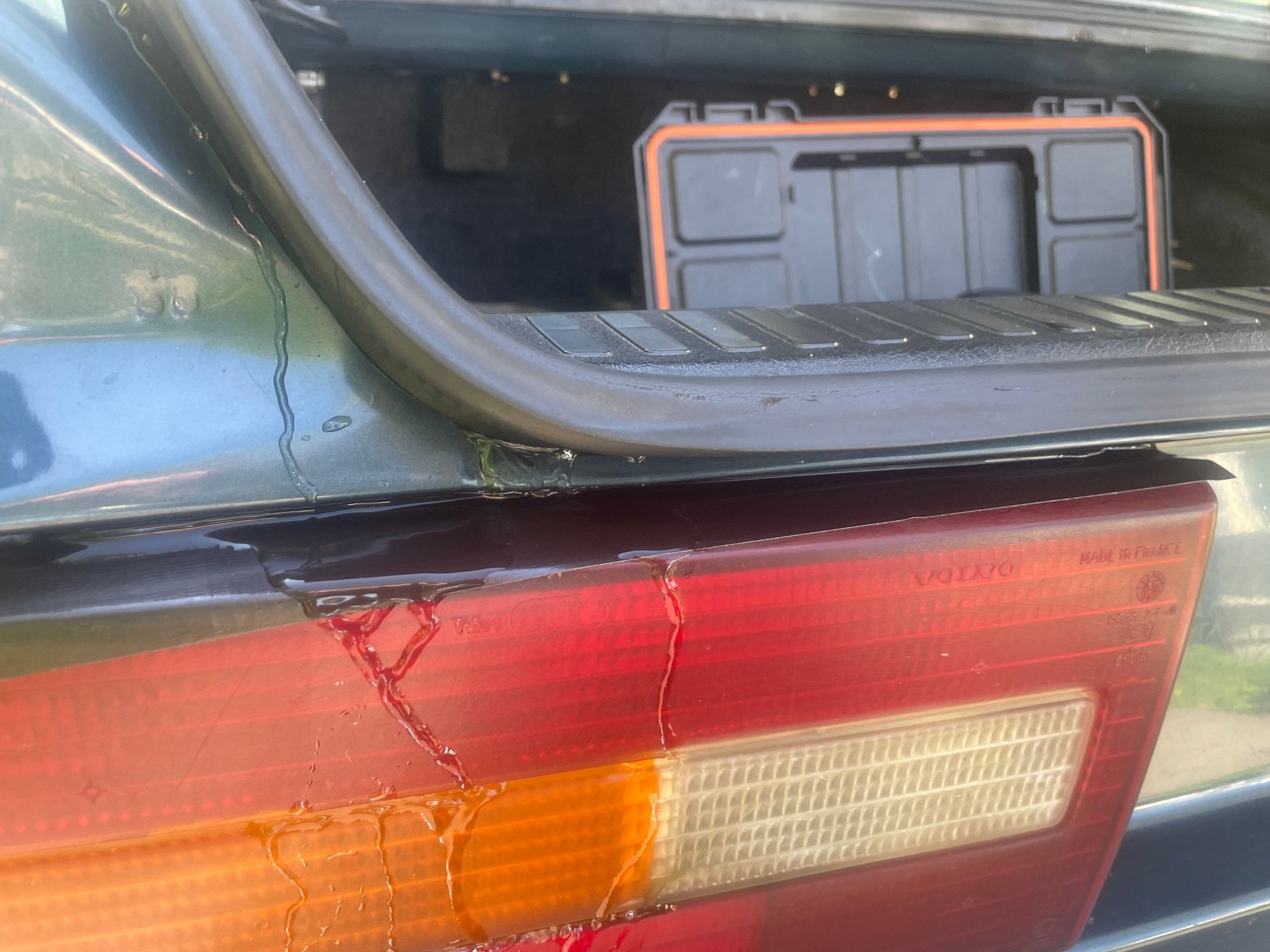

Hey guys. I have a 1990 740 GL (sedan). I have this same problem.
I think Volvo engineers screwed up here. (Blasphemy, yes. Quite open to correction.)

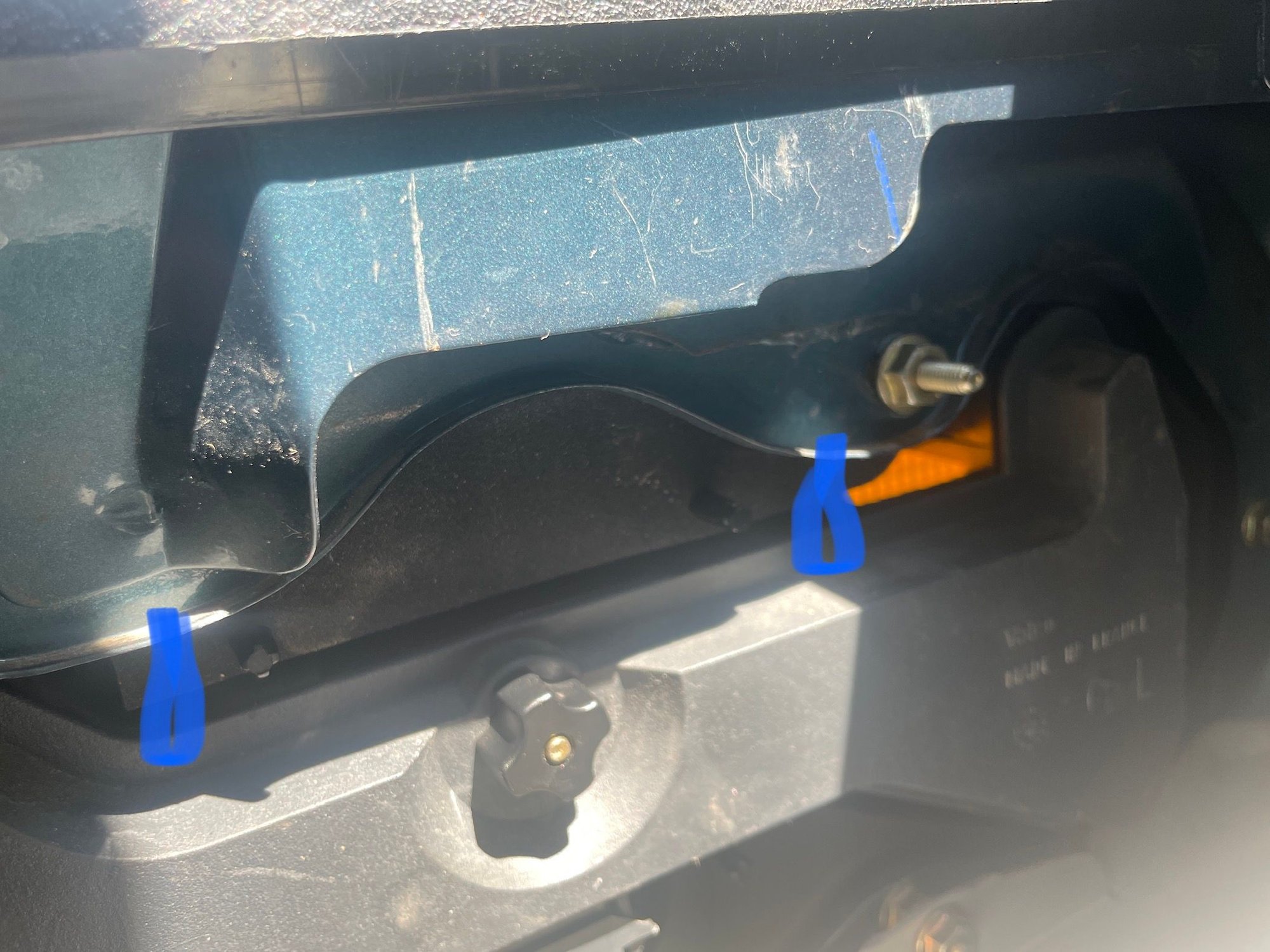

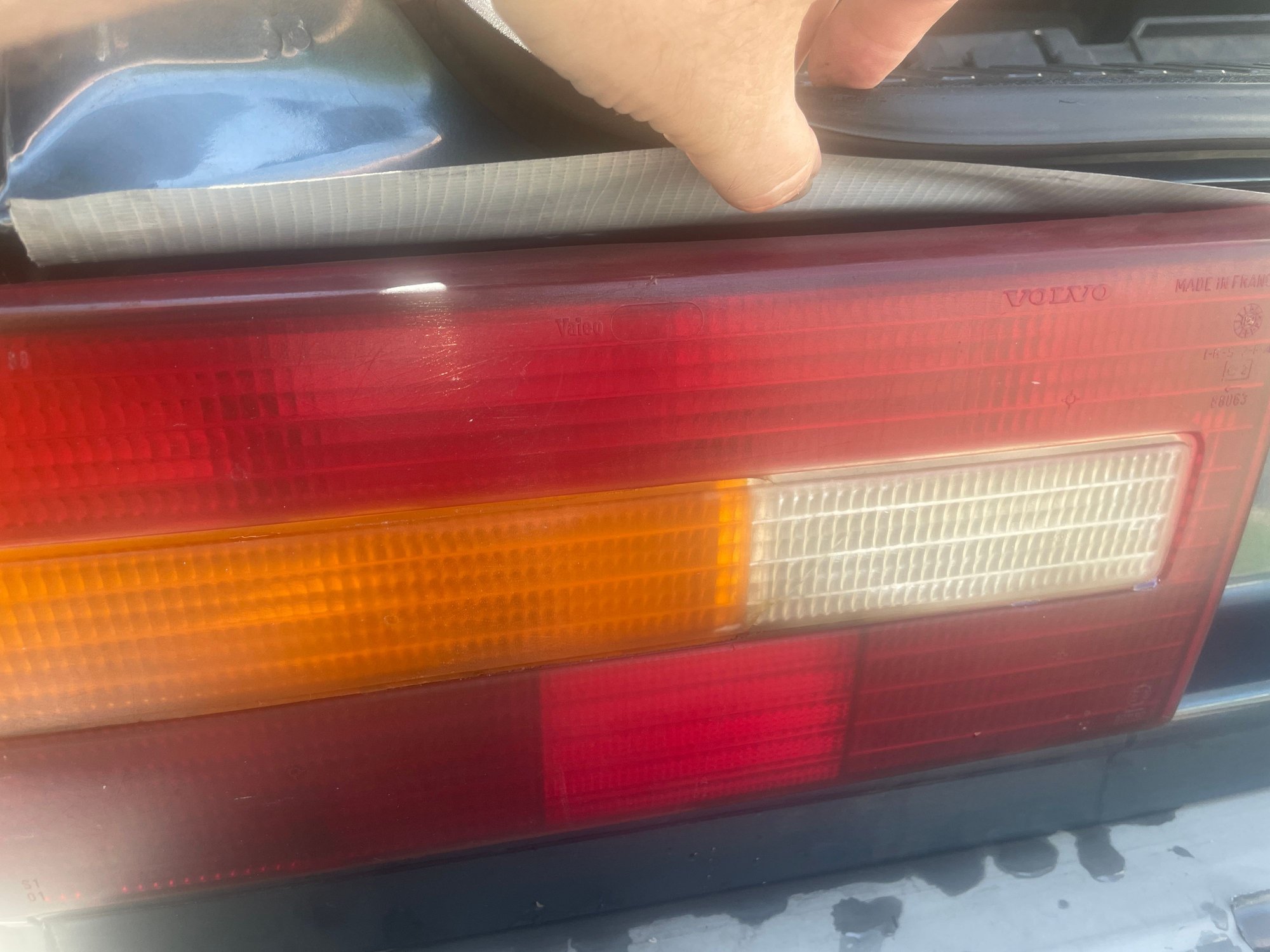

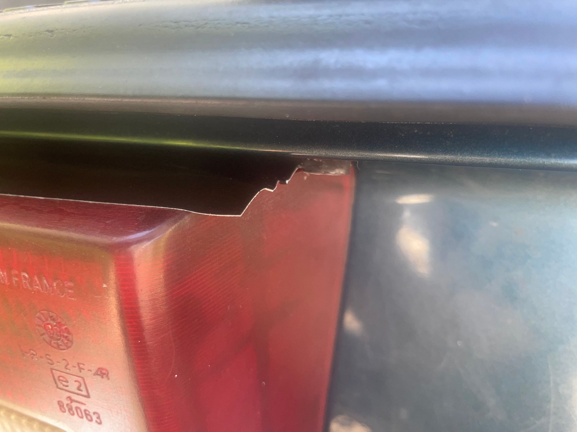

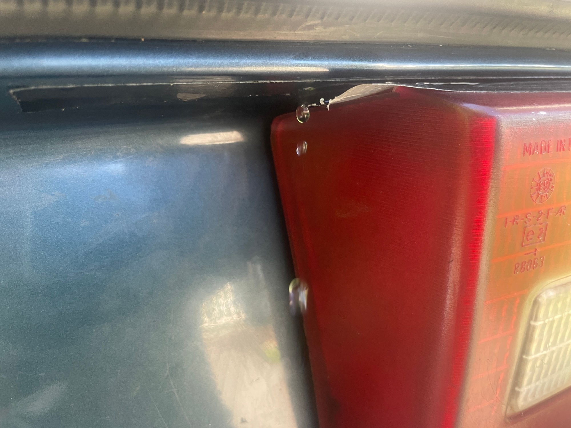

It's water running down along rim of trunk (also wicking down trunk seal) and onto tops of tail-lights and running into trunk through inside of tail-light assembly. Or it would be doing so here, if not for the tape I've put in place.
(Don't have good pic of drips happening on inside of tail-light assembly, even though I was water-testing quite a lot just now... but trust me that the drips happen where I've indicated. Thought they're also misleading; the water is running down the inside of those tabs, from the tops of the tail-lights, not the outside.)
Right now I've placed duct tape (not that artfully, yet, but effectively) such that it fills that dreadful gap and makes water runs down front of tail-light (and down "tape gutters" toward the license plate).

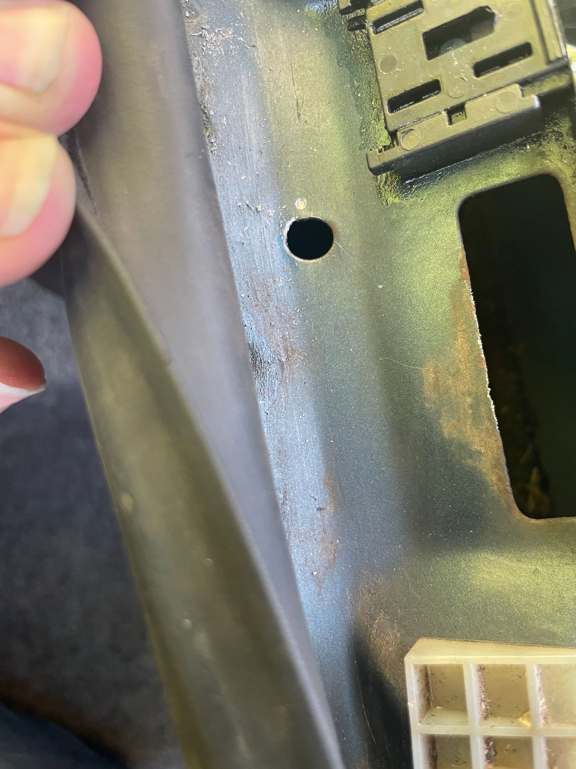

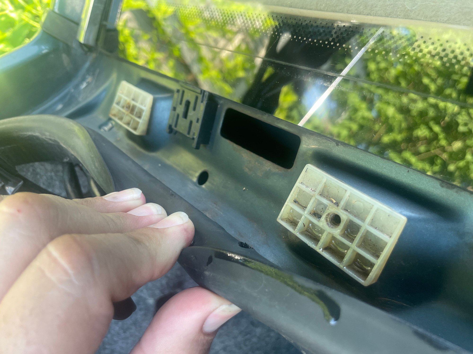

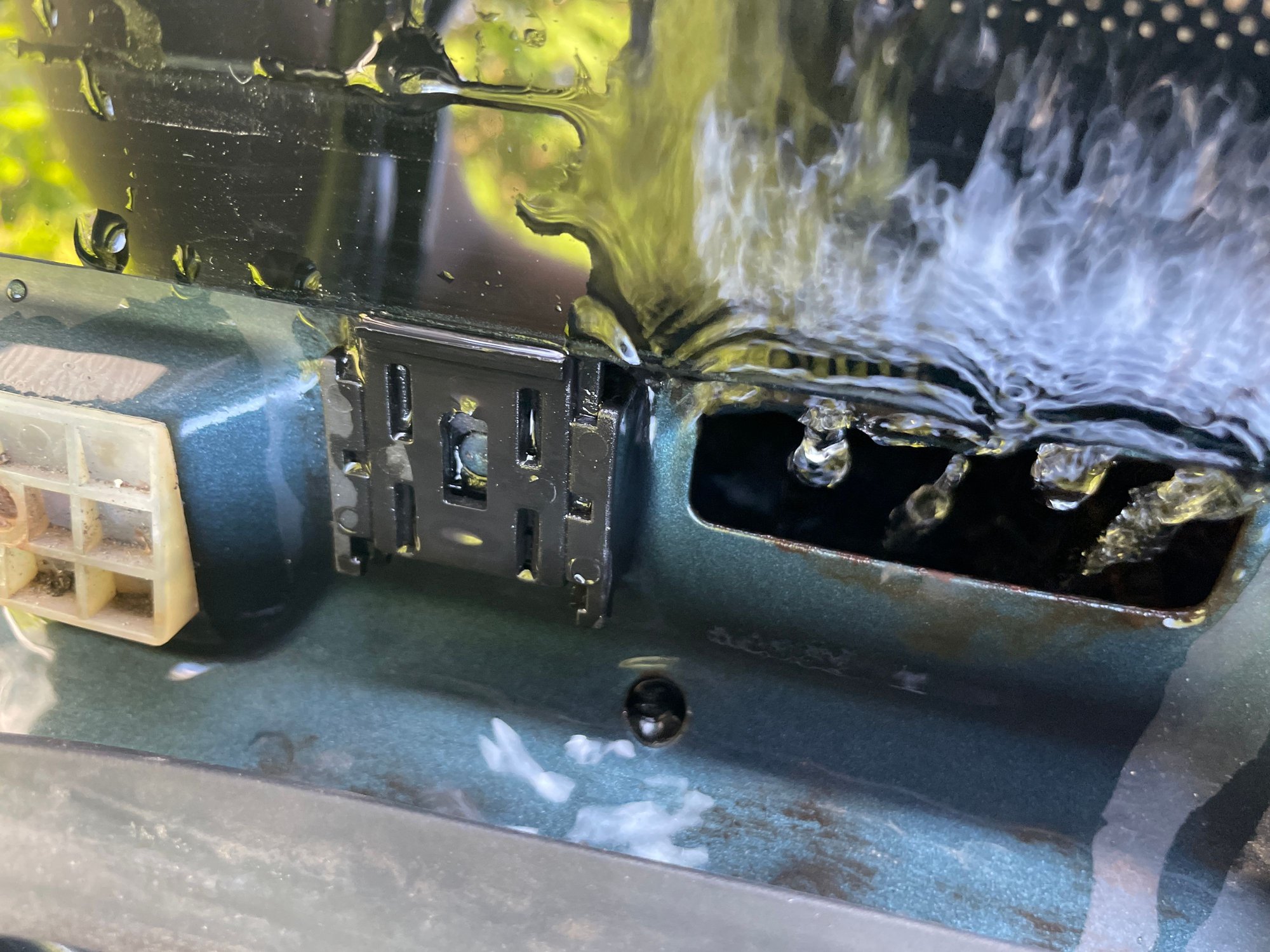

The cause of the problem (water tests confirm) is that Volvo didn't drill the drain-holes at base of windshield (which lead to big holes which lead to hoses pierce mentioned) large enough not to get overwhelmed when water is coming down hard (in which event surface tension wins!! See the convexity as water dips/runs across the tiny hole?)...
Tried drilling another hole next to original hole to make bigger hole. Volvo shrugged me off. I love this big steel brick. But I need a bigger hole!! What tool to use (or is there a better fix here)??

The foam seals of the tail lights are supposed to keep the water out. But they get hard and worse with time and make for leaks. The drains on the bottom of the bins are in case there is water, intentionally that way or not, the rubber plugs should be kept unobstructed, the opening pointing toward the back.
