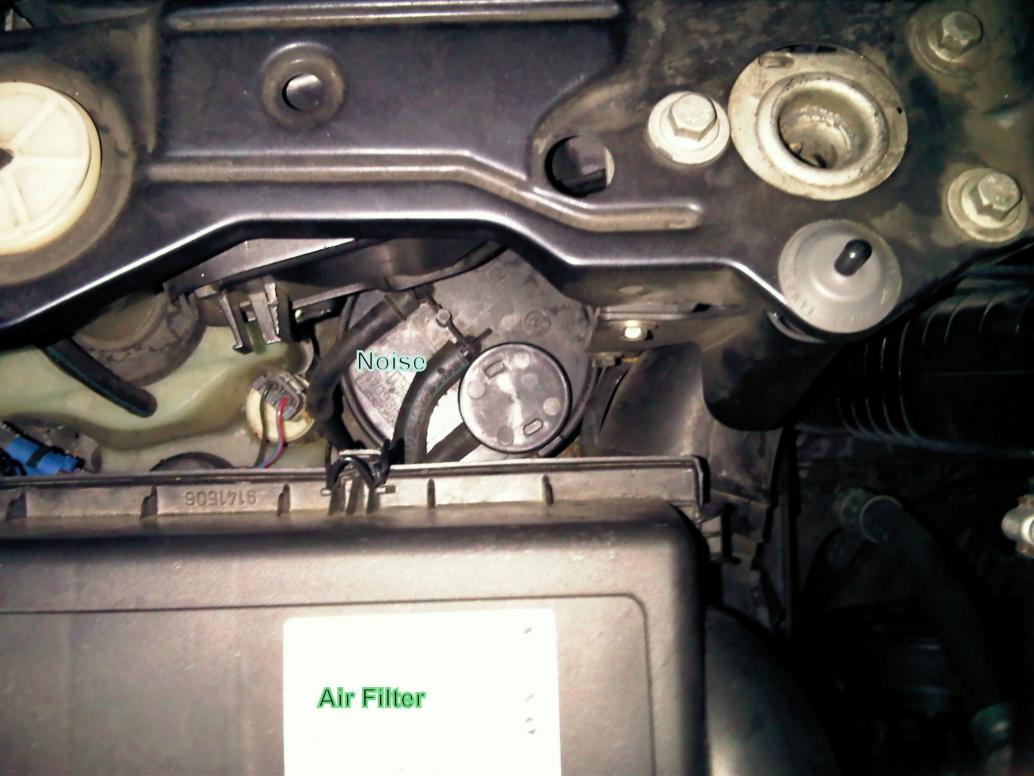

I have to type of notices coming from th engine compartment.
1. When the car is cold, noise comes from the steering wheel. (I assume it is an air leak) an goes away when engine is worm.
2. This noise is enigma to me. The screeching noise comes from this unit, right next to the Air filter. It happens randomly and when keys are inserted with Rdaio on and no engine running.
Appreciate some suggestions.

1. Are you sure it is from the steering wheel?
2. Does the car have headlight wipers?

Thanks for the reply.
1. Yes, because I have fluid leak in the steering wheel, and when I look at the fluid, it has air bubbles until the engine worms up. (My mechanic advised me just to monitor the fluid level, in lieu of costly repair).
2. I don't think the noise is from the headlight wipers. Because the I hear the noise directly from this unit.

When you have a fluid leak if it is low it will make noise.
The headlight wiper motor is just to the front of the air box which you pictured.

Agree in the wiper motor. I seriously doubt the charcoal canister would make any sort of noise when cold.
The sterring wheel noise is probably low fluid too as Tech said. If it's a high pitched or high frequency noise, probably fluid, but old, worn steering racks can thud and judder a bit when cold too.

After following the above, I did find that, one of the headlamp wipers was stuck on one place, and noise came from the wiper-motor trying to move wiper. To verify the problem, I pulled the wipers back from the glass (hanging in the air), and the noise did go away.

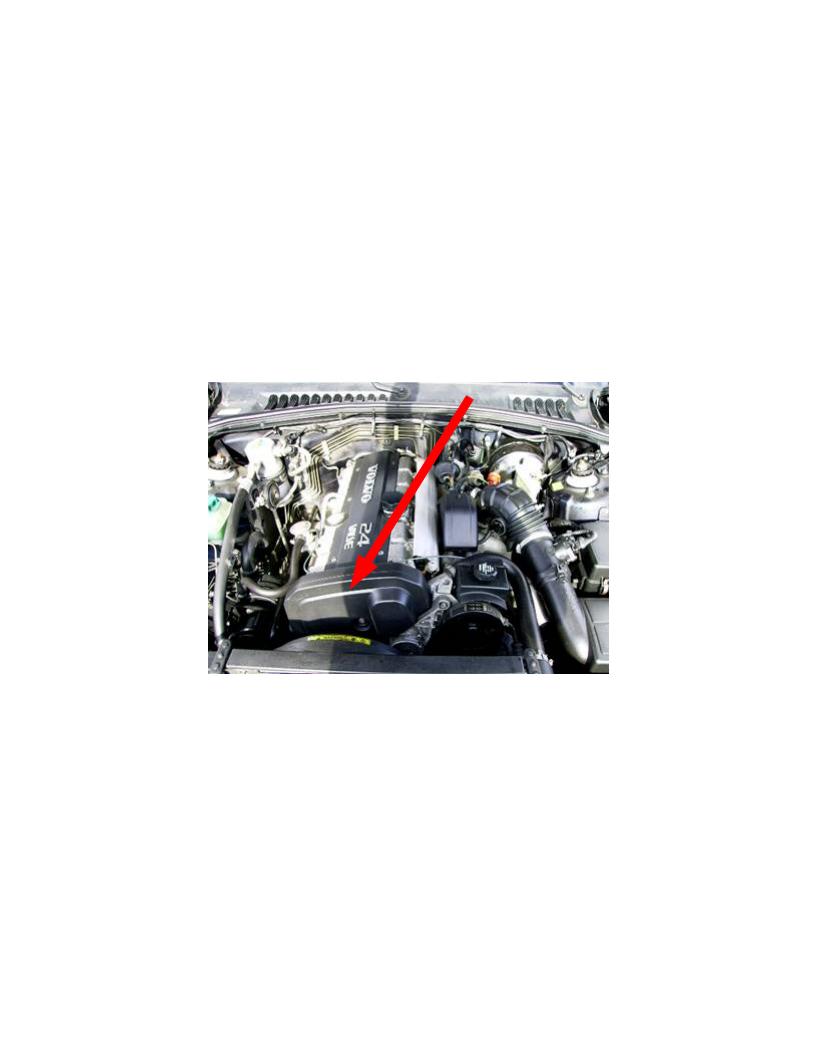

I am sorry to disturb you again. After I took care of the other noise (from the headlamp wiper), not I am hearing new noise from the are where the red arrow indicates. It comes sporadically, and mainly when engine is cold.
I have 20,000 more miles before the Timing Belt needs replacement.

I would pull the top timing belt cover and have a look. Could be the belt rubbing or frayed.
Post a photo here if need be.
Belts should be replaced on time in service as well as mileage, so if it's a low mileage car, it's probably due a new belt anyway.

Agreed check the timing belt and pulleys.

after following typhoon & tech suggestion. Timing Belt seem in good shape.
I tend to believe, the noise is due to the low level of fluid. (I do confirm, there is a leak in my steering wheel fluid). I also have noticed, the fluid turns whitish color (most likely air bubbles), which goes away after the engine worms up. The houses to and from the reservoir look in good shape and dry.

You need to check that out ASAP. My pulley was squeeling and it was almost locked up. Here is a post from what I found: https://volvoforums.com/forum/volvo-260-760-960-28/squealing-engine-compartment-37827/
My t-belt looked pretty new but when I pulled it off, I could hardly move my roller with both hands. It was just about locked up. Then my tensioner pulley was very loose, like it had not grease left in it. It would spin freely with hardly no force to turn it. I think it would have soon burned out the bearings and maybe even popped off. Either was causing damage to the belt, probably would not have lasted to much longer before I would have damaged the belt and busted the engine.
My belt had about less than 30,000 miles on it but the pulley was shot. I think that messed up my water pump. IMO, I think the belts need replace every 70,000 or seven years and the tensioner, pulley, and roller needs to be replaced every 10 years or with the belt. It's just not worth the risk of messing up something with a bad roller, pulley, etc.

rspi
After taking it to my mechanic, he pointed the same problem as you had indicted. The bearing on the tension pulley was dry (grease leak). Replaced both, the timing belt and the tensioner. All in all, it cost $460 (in Silicon valley CA) to replace the Timing Belt and bearing. I did consider Doing it myself. However, with no special tools, it could have been too complicated, with lots of room to screw thing up. My Mechanics did other thorough diagnostics for me for free, so it was worth the $220 labor.
