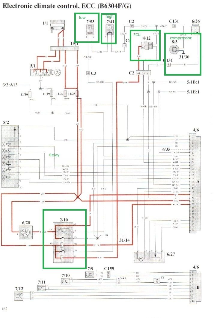

Here's a diagram from a 1994 - sorry I don't have a 1993. If you have the three pressure sensors on the condenser - it should be the same as a 1994.
Relay 2/10 is energized by the ecc module 4/6, the Engine control unit 4/12 lets that signal pass (if the car is not overheating) to close the contact in relay 2/10 and send compressor power to the low side switch, then the high pressure switch and finally to the compressor.

Thank you for the diagram and the info.
"If you have the three pressure sensors on the condenser - it should be the same as a 1994."
I do see three "somethings" side by side, all different colors, at the bottom of the condenser.

The low pressure switch would turn off power to the compressor is the pressure got too LOW (below about 20 psi) Anything above that and that signal goes to the high pressure switch on the condenser 7/41 that shuts off power of the pressure is loo high then finally to the compressor.
But you have no power at the low switch, Find the fan/compressor 2/10 relay - The pink with white wire coming from the ECU (with engine running/ac on) gets a ground signal from the ECC passing thru 4/12 the ECU . ( as I mentioned if the ecu think the engine is overheating it will turn the compressor off) you could ground that terminal (w pink/white wire) on the relay and see if power is then sent thru the green w orange wire to manually send power to the compressor via the two switches. Or use a jumper wire to send 12v thru the green/orange wire to power the compressor.

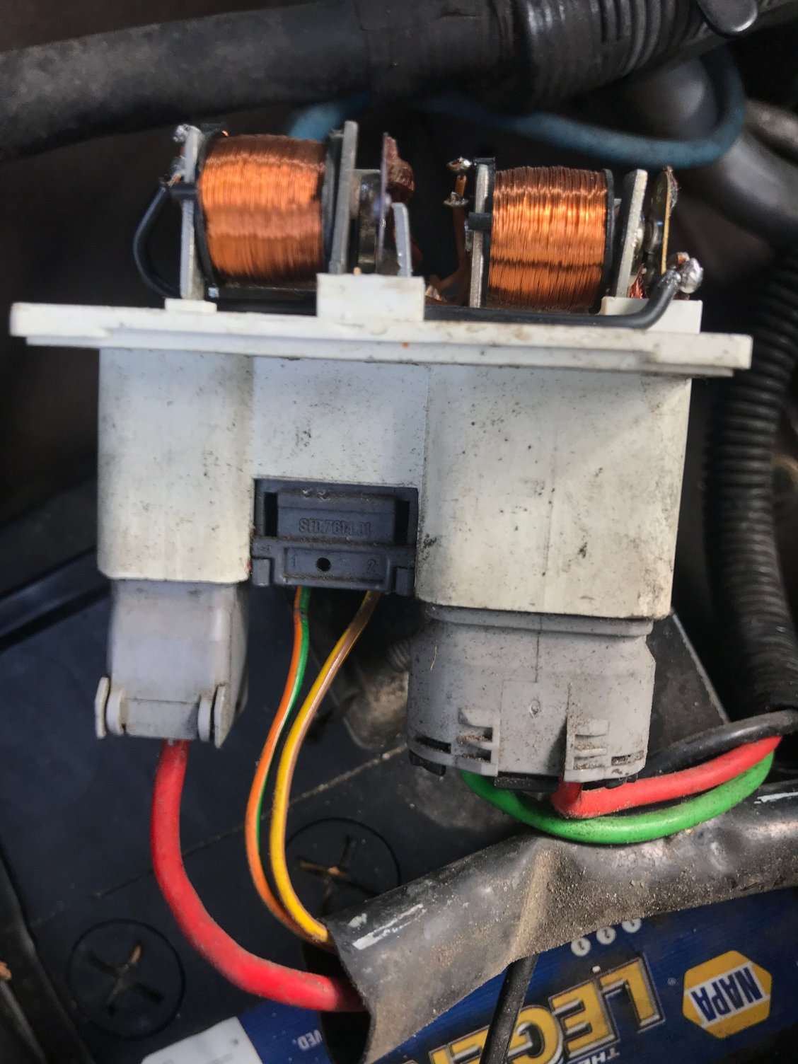

This is the fan relay. The plug in the center has wires with colors that match the wires on two of the sensors mounted at the bottom of the condenser. I believe these are the low and high speed (fan) pressure sensors. I'm not clear on how these relate to the low pressure switch on the accumulator, which I associate with the ac compressor clutch circuit.
One of the things I thnk I'm seeing is that once the clutch cuts out for good (when the car warms up to operating temp), the fan kicks into high and stays there.
Surely that's a clue...?

Yes that is the RADIATOR FAN relay. And yes 2 of those pressure sensors on the condenser are part of the radiator fan circuit and will turn the RADIATOR FAN on when there is a certain pressure in the ac system - maybe low speed at x pressure and high speed at x+ pressure. You have a two speed radiator fan. The 3rd sensor (one on the far right as mounted in the car, 7/41 in the picture above) turns off the compressor if the pressure gets too high - for instance if the RADIATOR fan is broken, then pressure will get too high but the engine may not be overheating (yet). The HEATER FAN resister and compressor relay 2/10 looks like what's in a previous post and is mounted inside the car - maybe behind the glove box near the heater fan motor as shown. The low pressure switch on the accumulator under the hood simply turns the compressor off if the pressure is below about 20 psi.
Your clue - certainly if the engine is overheating or the engine temp sensor is telling the ECU the engine is too hot - that will turn the compressor off and possibly run the RADIATOR FAN on high. Some of those 6 cylinder engines had 2 engine temp sensors - one on the thermostat housing and the other on the back of the head. Don't know if your 93 has one or two. A 1994 has two and only one of them reports to the Temp gauge on the dash. Pictured below is where the temp sensor 7/16 is on the back of the head and where the COMPRESSOR relay 2/10 is located inside the car. .
You have not mentioned if you have checked for self diagnostic codes - or are aware that you can. The ECU and the Climate system, as well as many other control units can store self diagnostic codes - maybe that will give a clue. Instructions can be found here. https://www.volvoclub.org.uk/faq/EngineOBDCodes.html
Heater fan resister, compressor relay

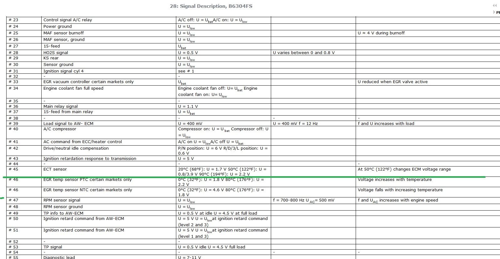

"...The 3rd sensor (one on the far right as mounted in the car, 7/41 in the picture above) turns off the compressor if the pressure gets too high - for instance if the RADIATOR fan is broken, then pressure will get too high but the engine may not be overheating (yet)." ---so a faulty high pressure sensor could be at fault? Can I assume there should be constant voltage here, and if not the problem is elsewhere? also, is it correct that disconnecting the connector and checking across the two contacts would be the way to test for voltage (same way as is done at the low pressure switch)
"The HEATER FAN resister and compressor relay 2/10 looks like what's in a previous post and is mounted inside the car - maybe behind the glove box near the heater fan motor as shown. The low pressure switch on the accumulator under the hood simply turns the compressor off if the pressure is below about 20 psi." ---- in other Volvos I drive, power to the low pressure switch comes through a relay behind the dash; however, I have never experienced a situation where there was power at the low pressure switch switch at first and then not, indicating that the relay fails during operation (I realize this is anecdotal, but the consistency of the symptom I'm experiencing in relation to engine temperature has grabbed my attention for the moment and I'm thinking this relay (if I can find it-I haven't been able to put my eyes or hands on it yet) is probably not suspect- at least not yet)
"Your clue - certainly if the engine is overheating or the engine temp sensor is telling the ECU the engine is too hot - that will turn the compressor off and possibly run the RADIATOR FAN on high. " ---how does one test this beast?
"Some of those 6 cylinder engines had 2 engine temp sensors - one on the thermostat housing and the other on the back of the head. Don't know if your 93 has one or two. A 1994 has two and only one of them reports to the Temp gauge on the dash." ---the temperature gauge is showing the engine temp in the proper range, so I'm hoping it has two and one of them is the culprit.

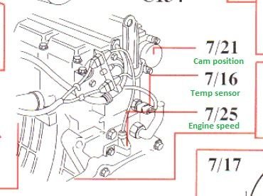

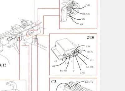

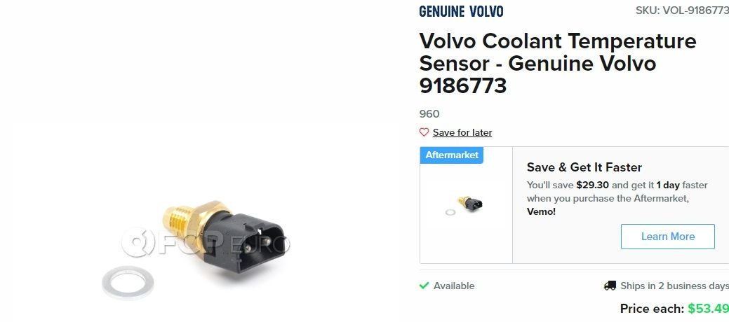

Wow! Thank you so much. I think I'll try to find the specs for that temp sensor online, or ask my mechanic. I'm guessing it will be a certain resistance reading?'
