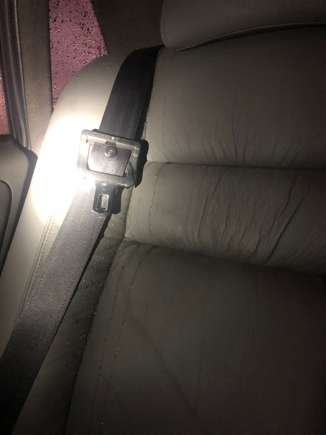

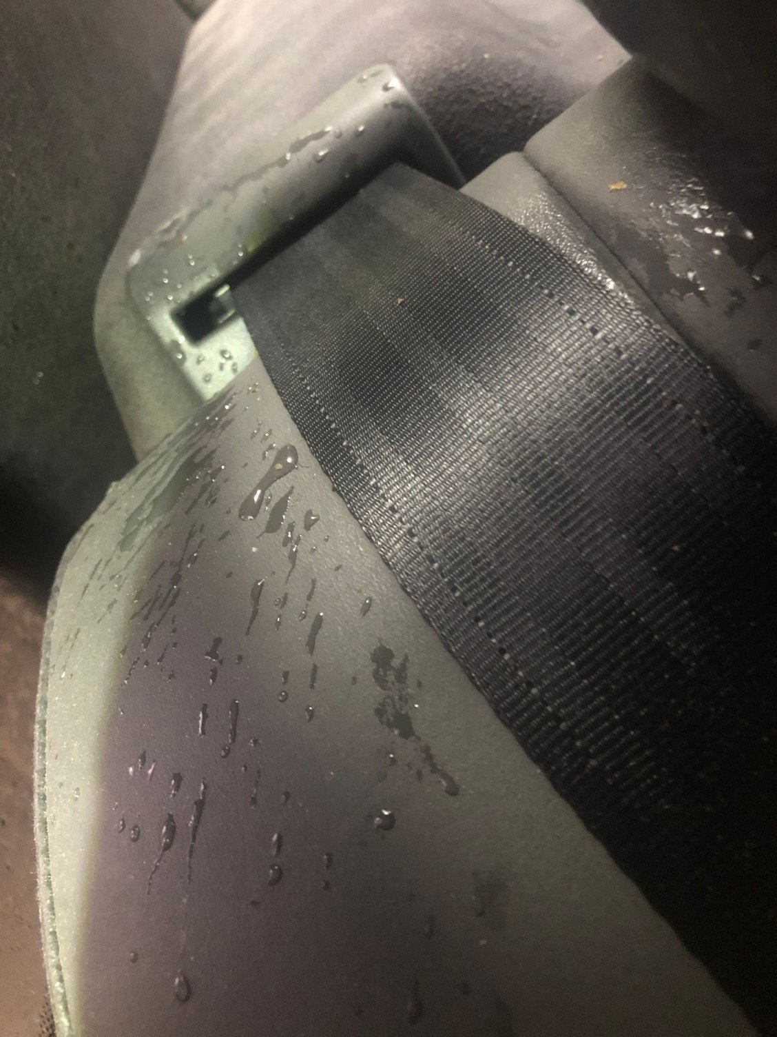

I’m new to having a Volvo 1997 960. I recently had an issue while working all day with a lot rain accumulation in my drivers side floorboard. My mechanic ran air through the sunroof channels. No rain in the front. I was sitting in my car, during and I kept hearing a slight feint dripping sound. I couldn’t figure it out? However, I go to pull off tonight, and I hear water stream wrapping against seat. Look back to discover anything the car surges forward, a stream of water comes down in the corner of the backseat, on the passenger seat side? Are there more channels he didn’t know of, or could it possibly be leaking from the back window seal? Let me know if you have any suggestions etc.through experience and troubleshooting the issue.
Location of the leak from falling onto the seat.
Possible entry point of leak?
