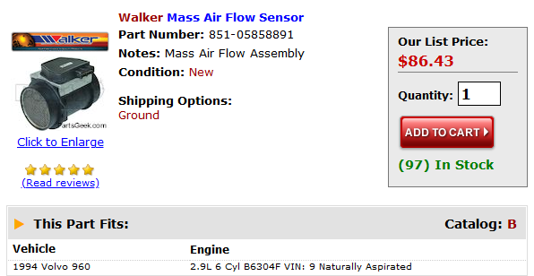

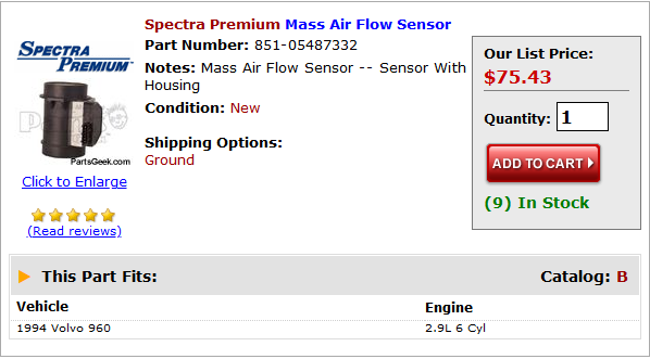

I need a new Mass Airflow Sensor for my 94 960 sedan. It runs very well generally but has had almost a valve chattering sound for long time under a very light load, similar to the sound in the old days of running too low octane fuel. My indy Volvo mechanic cleaned the MAF while he was making other repairs to my car recently, and this problem was all but eliminated, albeit only for a few days. So I want to try a new MAF and don't want to spend $200+. I've looked around checked prices and found a couple of NEW units for sale for between about $75 and $87 plus a rebuilt one for about $73 + $33 core charge, which I'm fine with the core charge.
There are 2 brands of new MAFs mentioned above for cheap compared to OEM. One is Walker which I know the Walker brand from Walker exhaust systems, then there's Spectra Premium which I've never heard of. Does anyone have experience with either of these brands of new not remanufactured MAFs? Also there's A1 Cardone remanufactured with the core charge. I'd like to try one of these three preferably a new one unless someone is convincing in explaining why not to use one of these 'cheap' new ones instead of a much more expensive Bosch OEM one.

So I thought this through and wanted to purchase a MAF sensor which didn't require a core charge and return of the existing sensor. I decided for the price, if the new MAF sensor worked well, then not only had I saved money but I would end up with a spare part and a good conscience that it wasn't wasted. I tried 2 different sensors one bad the next good, very good.
Perhaps against my better judgment and against the advice here I first ordered the cheapest aftermarket MAF they had in stock at Rockauto.com. It was a TPI brand with #MAF1068. This thing was a piece of junk. It started OK then began to idle rough after less then a minute. Then after driving some distance and coming to a stop sign, it idled rough again. After swapping back the original MAF the problems went away, so I wasted no time setting up a return. Got back most of my 60-couple dollars.
After returning it I shopped around, checked prices and availability at several places. Finally I bit the bullet and ordered the Walker 851-05858891 complete new MAF assembly from Rockauto.com. There is no core charge and so I get to keep the previous one which I confirmed works as it should.. I installed the most recent new MAF sensor the same day that it arrived and so far going on 3 weeks in service it's working perfectly. No change in performance, starting,fuel mileage etc. The price for the Walker was about $76 versus $95 + $35 core fee for a Cardone rebuilt OEM sensor. I would definitely recommend AGAINST the TPI brand MAF sensor and FOR the Walker brand MAF as a cheaper alternative to the OEM. Works great and if anything changes I'll post back.
