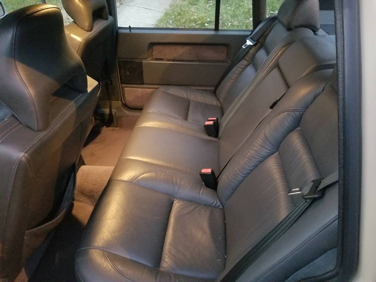

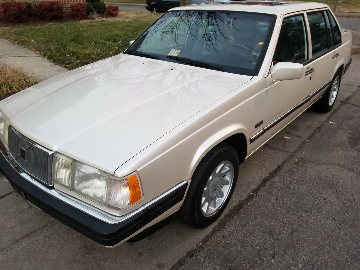

Hello all,
This looks like a pretty active discussion forum, which I'm glad to find this for an older Volvo that I just purchased, which is my third over the years. Now I am a proud owner of a new to me '94 960. I'll try to attach some pictures. Bought this on December 21st of 2017.

Nice looking 960

welcome to the forum again! and very nice looking 960, wish mine was that clean!

This car must have been a southern USA car all of its life. The body is not only rust free at 155K miles, I couldn't even see any surface rust underneath when I knelt down and looked underneath before I bought the car. With excellent body, I can concentrate mainly on the mechanical stuff and hopefully keep this running for a long time now.
