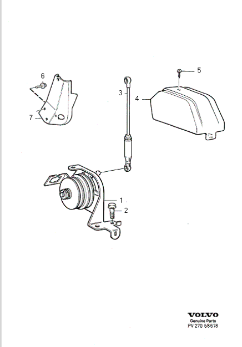

There's a little "ball and socket" style arm (approx 3" long?) that attaches on one side to the throttle body and on the other end to a spring-cable device which essentially is the accelerator cable. One end of this arm's socket has worn to the extent that is won't stay attached to the ball. So when you push the accelerator peddle, nothing happens because you're disconnected. I can't find the part number for this arm. Nor can I find the part on the various Volvo parts websites. Has anybody had this happen, and/or know of where I could get a replacement part? I haven't called the dealer yet. At this point, I'm thinking that might be my only option unless I happen to find a salvage yard that has some older models with the similar 2.9 ltr engine.

Took some digging. At first, I called my local dealer (Byers Volvo) and they said the part is only available by buying a whole throttle body ($300+). But this morning I thought..."the internet is a big place". So I started digging and found a couple dealer websites that had good parts pages with drawings. Eventually found the linkage I needed (pic attached). So my dealer was wrong. Word to the wise, don't always trust what the parts guy tells you....he might be wrong or misinformed. Makes me wonder what drawing he was looking at. Kudos to Lisle and Oak Park Volvo dealers. Both have good websites with drawings that let you (the buyer) search til your eyes are red for that elusive part.
