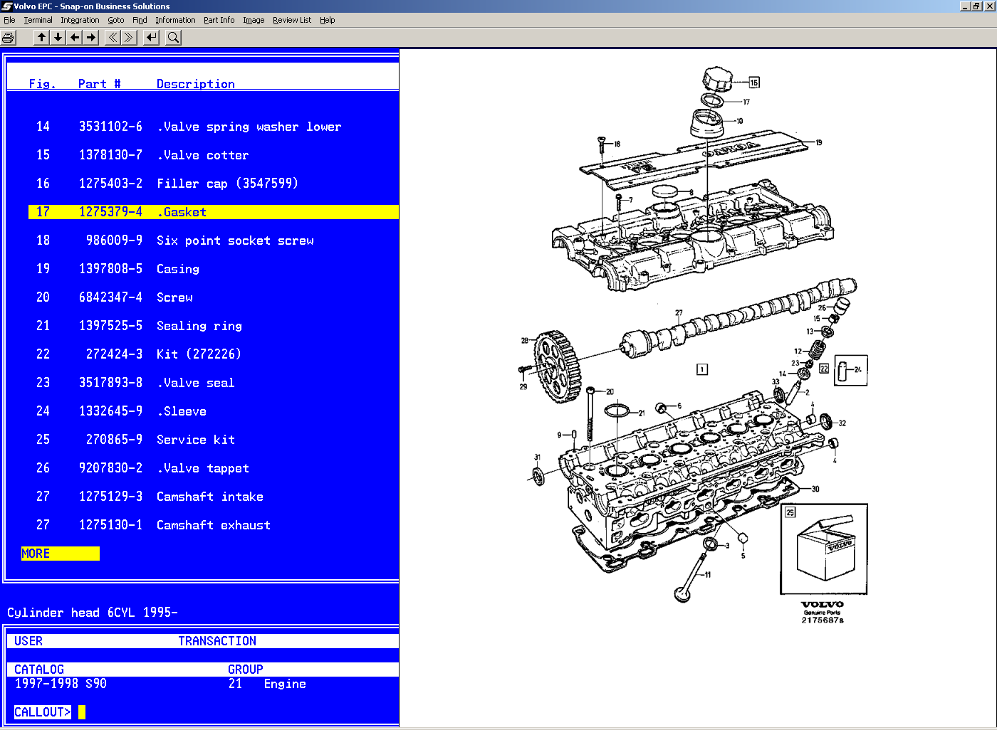

If it is the oil filler cap, you can replace the seal.
If you spill oil while filling, it will get under the cover and collect where oil is in your photos. Be careful and use a funnel.
https://i.imgur.com/H5A5S9l.png
