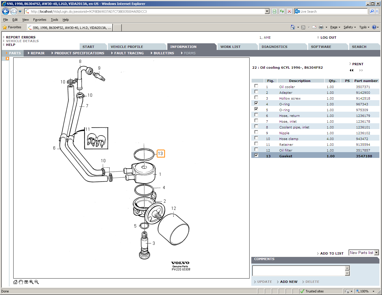

I have a similar problem but cannot find a part number unless it's just an o ring
Old Apr 23, 2015 | 01:21 AM
VDonkey's Avatar
Joined: Oct 2013
Posts: 260
There are three gaskets, one block cut ring and two o rings. On my car, it seems it was only the block cut ring was leaking.
You'll need a 41 mm socket to remove the banjo bolt.
This can be caused by age or by abuse when presented with difficulty removing the oil filter.
Do you need part numbers? See image at https://i.imgur.com/HvYvw8Y.png
