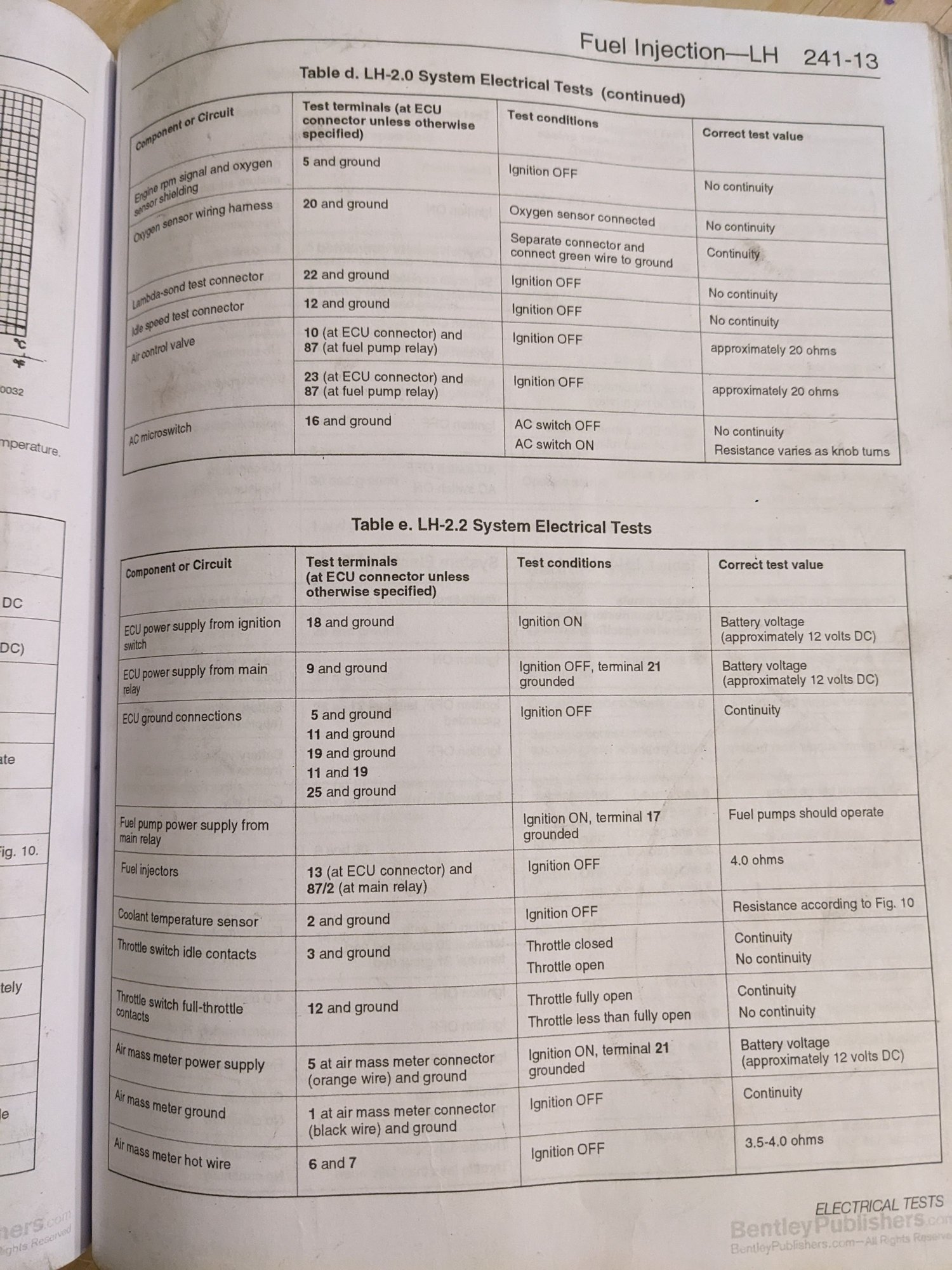

Check out my page. I just uploaded a whole bunch of wiring diagrams for a '84 240. A lot of it will translate to your car if you know what fuel and ignition system you have.
From the sound of it, you have a charging issue. Being that you died on the road, but it started and ran great at first. Dive into the battery and alternator and make sure those components are good before my moving on.

I can send you photos of the Bentley manual too if you need it. You can do all fuel ecu checks step by step with it. It removes all doubt. Ignition system too.

that would be great if you could send me photos of the instructions for checking ecu! We fixed alternator and battery issues a while ago. Doesn’t start with a junk either…

LH 2.0-2.4 system electrical tests
