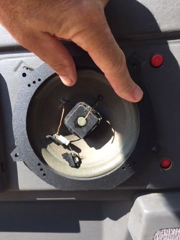

You will have to remove the speakers from the door panels if they are riveted to the door panels like mine. Check out the first picture below, this is my driver's door speaker with grille missing, you can see gray or silver rivets/anchors which mount the speaker to the door at four points. I guess the easiest thing would be to drill out these rivets, pull the speaker out of the door and take a reading across the two terminals on the back of the speaker with an ohm meter, WITH one wire disconnected from the speaker. You don't have to disconnect both wires but you do have to disconnect one wire to get a valid reading. If it is infinity/max resistance, then the speaker is completely open (no good). If it reads almost zero ohms across the 2 connections on the rear of the speaker with one wire disconnected, then the speaker is probably OK i.e. not blown. As you can see in my pictures, my speaker is broken. A component across the speaker called a capacitor which acts as a filter has one lead broken and the speaker's tweeter horn is broken off of the speaker. Awhile back I bought a set of ABS plastic adapters for a 960 (see the adapter being held over the mounting points for the existing speaker in the second picture below) that can be attached to the doors via pop rivets after drilling out the old rivets and removing the OEM speakers. Then attach a replacement 5.25" speaker to the holes in the adapter. If your speakers are shot, then this to me is the easiest replacement. If you have or can borrow or buy a cheap pop rivet gun and some rivets of the correct size and length, it looks like you can replace the speaker without having to remove the door panel. Just drill out the rivets mounting the existing speaker to the door, pull the speaker out of the door, disconnect one of the two wires connected to the speaker, and take a volt ohm meter set to resistance/continuity and take a reading across the speaker.
I plan to replace my front door speakers very soon, as soon as I can get a spare hour or two. Then I'll post the results on this forum. Neither one of my front door speakers work, only the large speakers in the rear deck work great and the front speakers in the dash make a tiny bit of high frequency noise which to me doesn't sound normal but I don't have anything to compare to i.e. another 960. Later on after replacing the front door speakers, I plan to replace the in dash unit with one of these double DIN units with bluetooth, possibly CD, USB, AM/FM radio, etc.
Hope this helps.
Original front door speaker, broken:
Same location holding the speaker adapter for new 5.25" speaker over top of the existing speaker, showing that the adapter connects to the existing holes in the door and the new speaker will attach to the adapter's mounting hoes with screws. They provide three sets of mounting holes for speakers in the adapters. I don't remember off hand but I think I bought a set of two adapters for about $15 plus a few dollars shipping, less than $20 altogether. They only list the adapters for the front doors on a 960. I haven't checked to see if they also fit the rear doors. My rear door speakers don't work either. I probably have a bad head unit or amplifier. If my new front door speakers don't work at all with the existing in dash unit, I needed to replace them anyway and they will work with a new car stereo.
