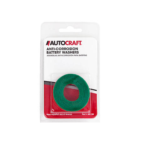

It's also good preventative maintenance to put on "battery washers" or some terminal grease to keep the corrosion down. Used to think the washers were a joke till I used them. They work great.
Attached Thumbnails 1993 850 starter/battery issues-battery-washers.jpg
