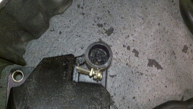

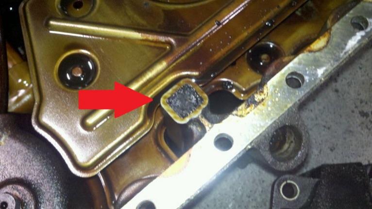

I used to always recommend replacing the PCV black box because I thought it was baffled in a way that would make it too restrictive to be cleaned and that the box itself could get plugged. It does have a baffle but not much of one.
Well now I've seen one cut open I believe it's cleanable and it's very unlikely the box itself would plug. The rubber lines definitely can break down on the inside from the heat and vapors and you don't see it so do all the vacuum lines for sure. If you're in there doing the PCV vacuum lines it's a good time to replace all the vacuum lines as the stuff is only about a buck a foot and then you're saved from it causing a future problem.
You want to make sure the passages the black box uses for separation and drainage are open. The passages being blocked is more of a problem and cause of the crankcase pressure and blowing smoke out the dipstick.
Attached Thumbnails 1994 volvo 850 eats oil-pcv-cutaway.jpg   1994 volvo 850 eats oil-pcv-box-plugged-port.jpg   1994 volvo 850 eats oil-pcv-oil-pan-passage-blocked1.jpg   1994 volvo 850 eats oil-pcv-view-box.jpg
