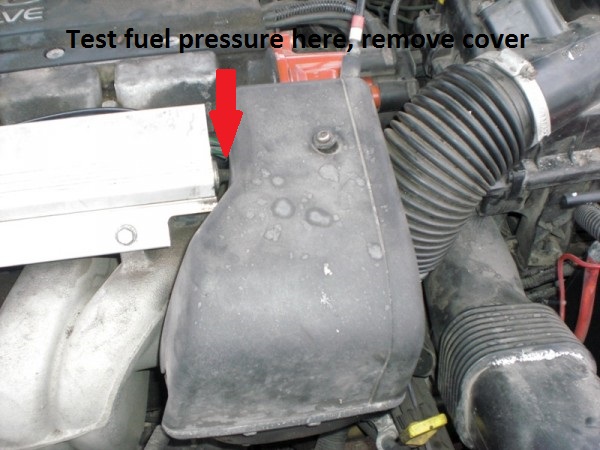

If you can get a hold of a fuel pressure tester I'd screw it on and read the pressure in the fuel rail.

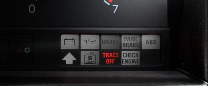

To check to see if the light is working just turn the key to "ON" and look. It should light up for a few seconds.
I checked to see if it was on and it wasn't, I never knew just turn key to ON position I figured it was like a chevy and would be on while its running lol thanks. Ill try to get my hand on a fuel pressure gauge and see, did the video work for you yet?
