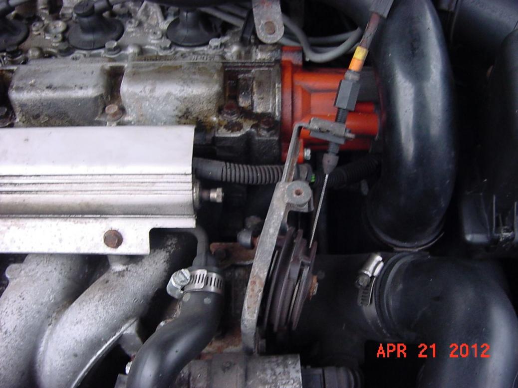

To check your fuel pressure you need a gauge and it screws on to the schrader valve at the drivers side end of the fuel rail (picture 1)

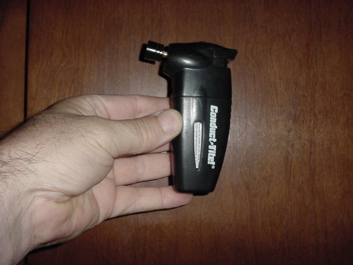

I've used a torch for cleaning plugs on a lot of cars. Even more mowers and snow blowers. Snow blowers don't dry out when it's below zero Put a glove on one hand and just heat the plug until it quits giving off a yellow flame. I live in Minnesota and back when there were carburetors everywhere it was very common in winter months to have vehicles dragged in that were so flooded you needed to clean the plugs, put the torch to the cylinder hole and hear a "wosh" as the fuel in the cylinder ignited and once you fired it up and ran it a couple minutes, drop the oil and filter as there was noticeable gas in the oil. Never had a problem using a torch. With iridium plugs running 6.99 each I'd still use a torch as it's the best way to get them clean from gas or from carbon fouling, second only to just replacing them.
Just not a big torch !!
