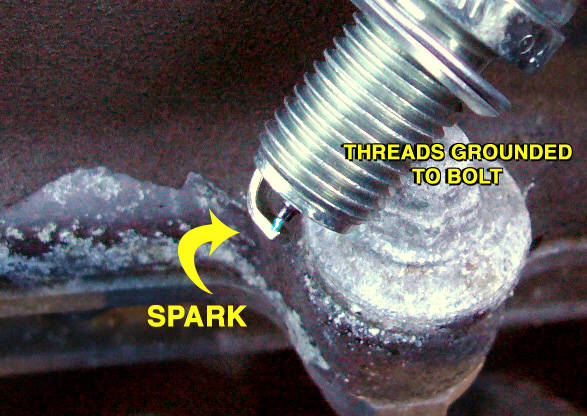

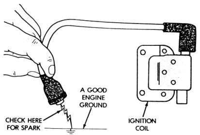

Take the ignition wire out of the center of the distributor cap and set it within a 1/4 inch of something metal that will ground it. Turn the car over and see if you have spark.

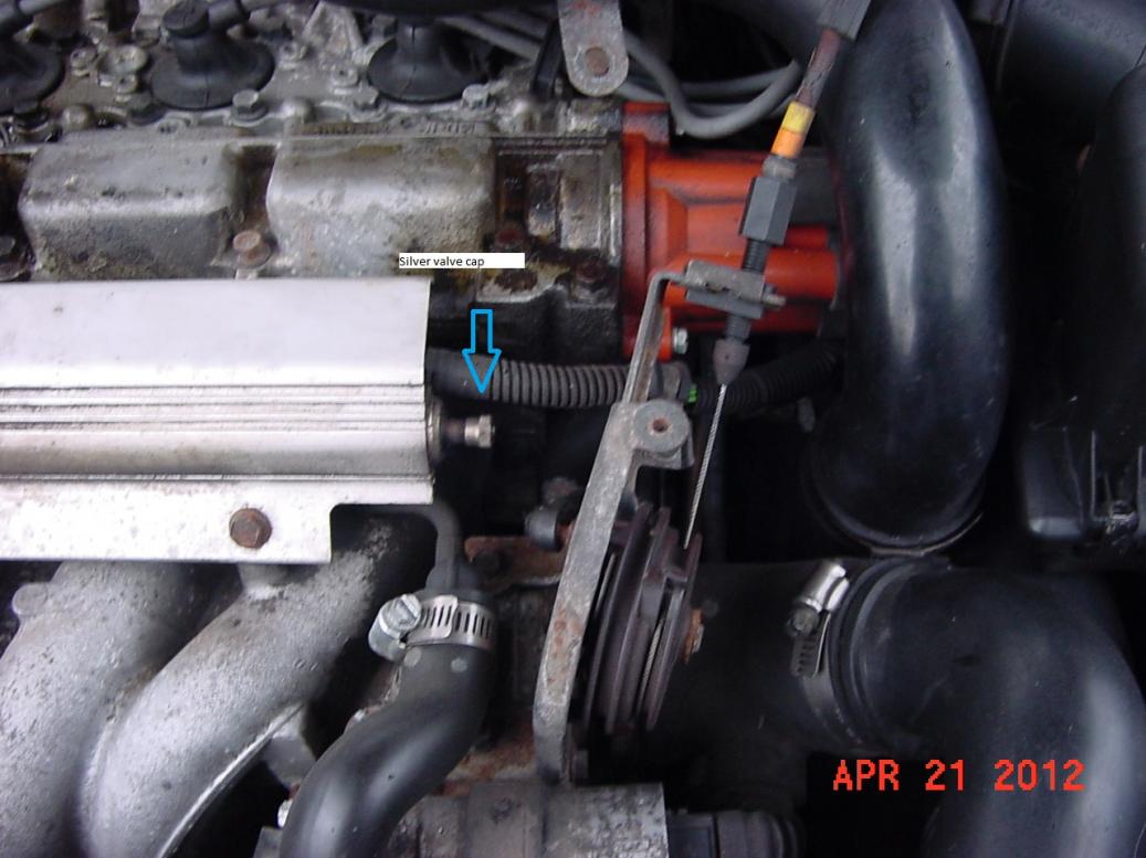

At the end of the fuel rail near the distributor cap is the schrader valve for the fuel rail. Once you've cranked the engine over you should try to push the vlave in to see if you have pressure. Warning: if you have pressure it will squirt out. Use a small screwdriver or whatever to push the valve open. Have a rag or towel right there to catch any fuel. It's the same type of valve used in the tires valve stem and works the same way.
Best not to hold the wire with your hand. If the wire is bad it's possible the coil will fire through your hand and you'll get a high voltage wake up call.

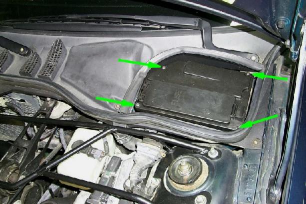

Location of the fuel pump relay.
There is a way to DIY repair them if you feel handy with a soldering iron.

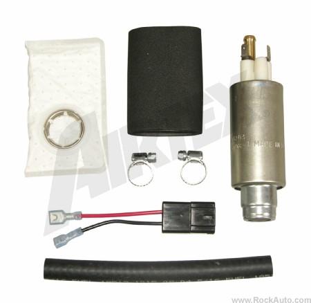

The fuel pump may not be the correct one for your car. That Airtex number is for mine.
Attached Thumbnails engine turning over but wont fire! HELP ME-fusebox.jpg   engine turning over but wont fire! HELP ME-fuse-box-underhood.jpg   engine turning over but wont fire! HELP ME-fuel-pump-relay-2.jpg   engine turning over but wont fire! HELP ME-fuel-pump-airtex-e8643.jpg

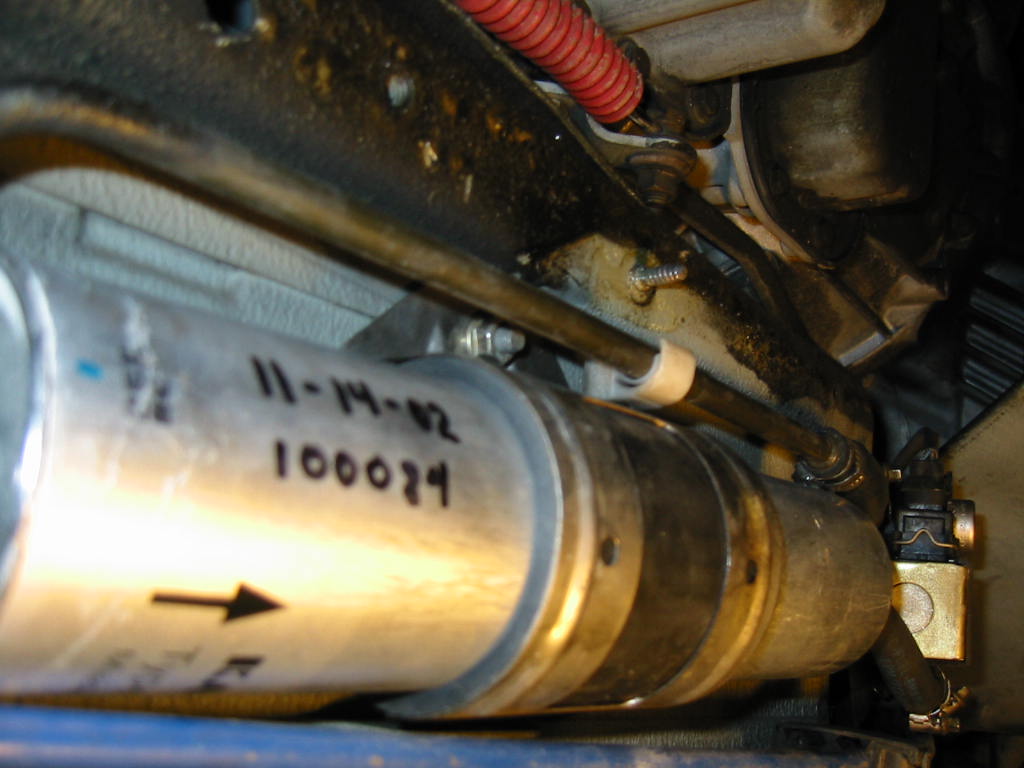

It would be wise to do the fuel filter at the same time if you're not sure when the last time it was done.
If you use a little paint like a touch up bottle to record the date and miles on it makes it easy to remember the last time.
Attached Thumbnails engine turning over but wont fire! HELP ME-fuel-filter-recorded-miles-date.jpg

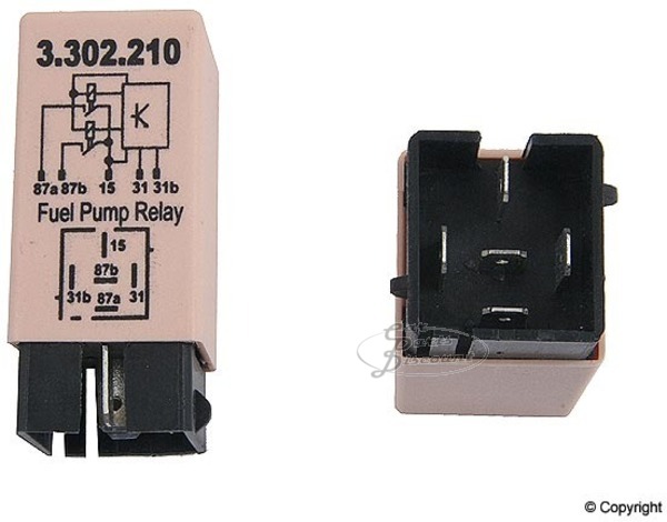

If you remove the relay it should have the contacts numbered on the bottom or a picture of the contacts numbered printed on the side of it.
Jump between 15 (top center) and 87a (bottom center) with the key on. If you then hear the pump in the tank running you know it's the relay not sending enough power to the pump.
If you hear nothing, it's likely the pump but it could be a bad connection so keep your eyes open and inspect all the connections you touch taking it apart.
http://www.volvoclub.org.uk/tech/ser...ests-Turbo.pdf
The picture is from a 96 and may not match yours but it gives you an idea of what I'm talking about.
Attached Thumbnails engine turning over but wont fire! HELP ME-fuel-pump-relay-volvo-850-1996.jpg

If you tapped on the pump or hit the tank and it started than its 100% the fuel pump
But if you want to test the relay just for the hell of it just get a small piece of wire and jump pin 15 to pin 87..
