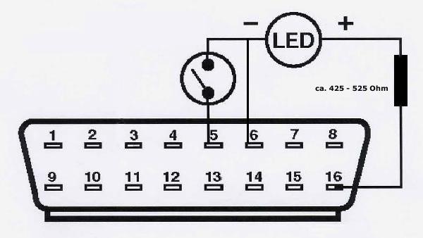

The blue relay controls the A/C compressor. The resistor which you replaced regulates the speed of the fan. The resistor is controlled by the ECC unit. The fan has permanent +12V.
The blinking lights from the control unit signals that there are errors. You can make an self diagnose box (look at the pic). With it you can get the errors and also delete them.
If replacing the resistor did not resolve the problem I think the culprit is the control unit, BUT I STRONGLY ADVICE TO READ OFF THE ERORRS FIRST!
Changing parts on hunches is an expensive business..
Cristian
