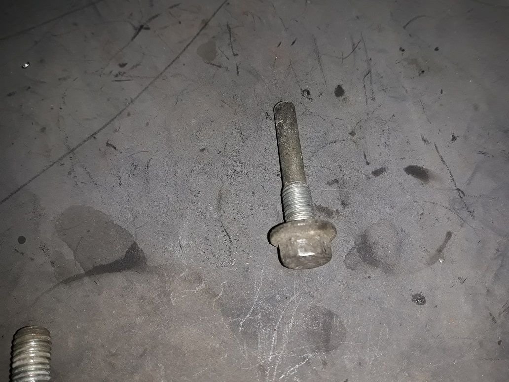

That would be my second rebuild (fixed a busted head gasket first time around), and it's almost done now. But, I'm left with some screws O.O No idea where they came from, any thoughts? I have two of those left...

I don't recognize that at all. Ordinarily, I wouldn't post something like that, but in this case, I think it's useful. I am working from home and I have 2 850 engines sitting in my office, and one of them's dismantled.. I have personally removed many alignment pins out of 850 aluminum castings, too. Plus you get a bump and maybe some of the other 850 guys will look.
