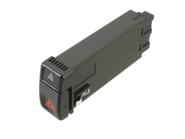

The flasher control is in the switch. I would try to whiggle the key in the ignition when it is started to see if that helps. If not, you can try pulling and replacing the switch/controller.
Old Apr 26, 2013 | 03:12 PM
What he said, it's likely the switch that's bad or stuck on.
Inside the emergency flasher switch is the flashing control for the turn signals too. It's pretty much the only thing that can cause the problem you describe.

Have now fitted a new switch {second hand from classic Volvo shop} all works fine Thanks for the help
