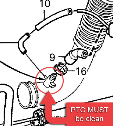

If you saw oil did you clean it out? Did you remove the intake hoses and clean them ALL out? The hose at the bottom of the intercooler can pool oil or antifreeze if you have a leak upstream of it. It can also pool condensation so if you see a bit of thin liquid there is a chance of that.
Did you clean out the PTC valve and if you pulled that intake hose (turbo to air filter) did it look like oil was on the walls from the PTC to the turbo?
Sorry for all the questions. It's possible you have a intake valve stem seal going bad and it's sucking oil in along the guide. You would still have normal compression as it would leak with the valve open and vacuum (the intake down stroke) applied to the guide?
You might want to check the throttle body to see if the throttle plate is oily. Clean it, run it and check it again. If it gets oily again after cleaning and you've cleaned the PTC and the intake tubes it pretty much has to be something in the intake. Hopefully it isn't a seal in the turbo.
Attached Thumbnails 850 R Burning Oil out of Exhaust.-ptc-valve-location-intake-tube.jpg

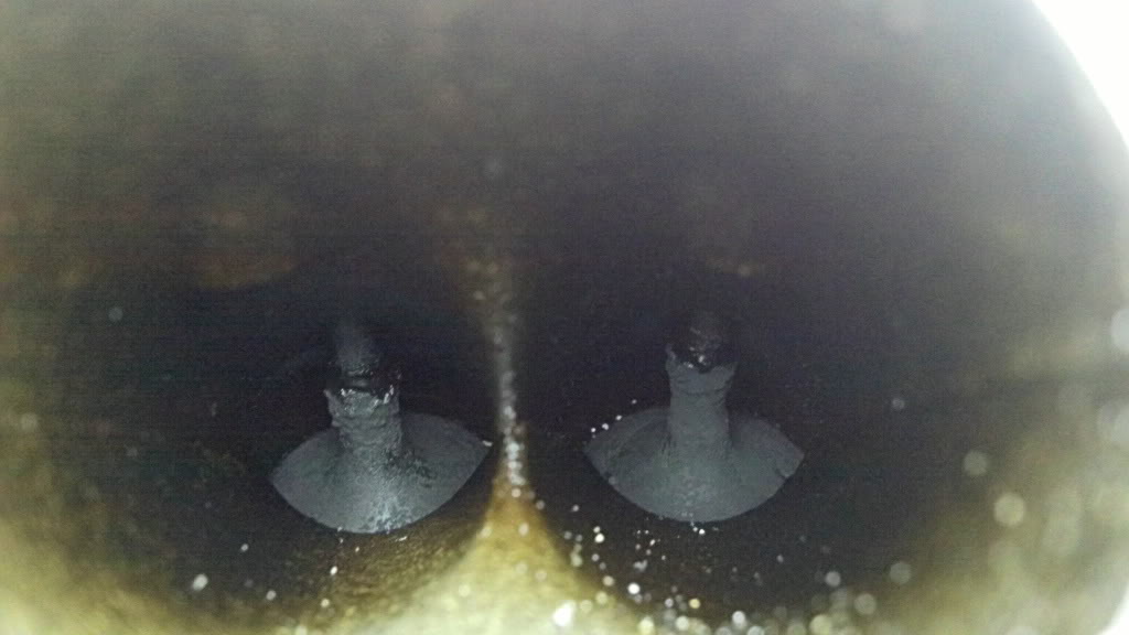

I can't think of a test for it other than doing a visual inspection. On the Volvo it's more difficult as I'm used to just pulling off the sheet metal valve cover and seeing if the seals looked cracked or loose. If you pull the intake or exhaust you should be able to see the valve and if it's been leaking for a time it should have some oil build up (caked) on the underside of the valve.
Stole the picture off a different site

So if I pull the intake manifold off should I be able to see something worthwhile (as far as the pictures goes you attached) with the valves ? If everything looks spotless then would you lean more towards turbo rebuild or re-checking the PCV system ?
Old Nov 27, 2011 | 06:26 PM
Pretty much. If it's been smoking a little here and there for a month or more it should have left a trail onto the valve.
I'd pull an intake tube off just to see if you have one that's oily inside. Since they are new and you did the PCV there shouldn't really be any oil in there. If a seal on the turbo is going it could leak into the intake or exhaust.
