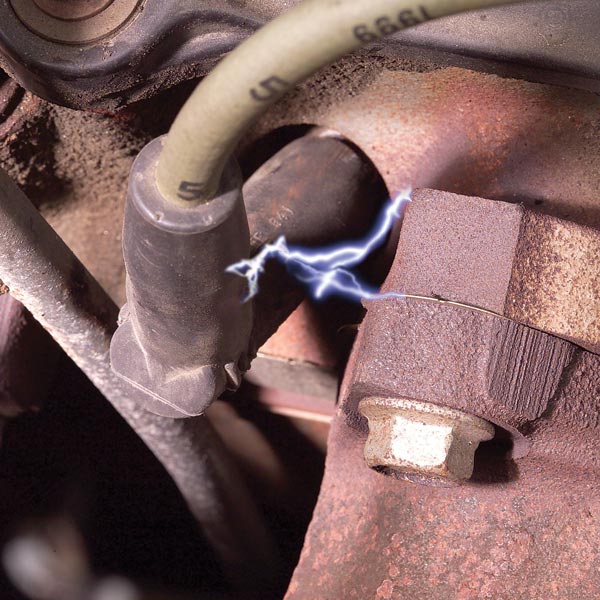

What year 850 is it and did you clear the codes and try to read them again since you've done the TPS ??
Have you checked for spark yet ?? If not, that's the number one thing to do before replacing any parts.
Have you checked the cap and rotor ??
You might not have any spark or you might have a bad coil wire shorting out due to it's insulation breaking down, cracking.
Post what you find.
