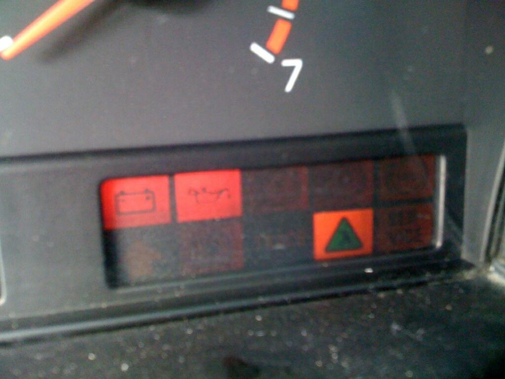

Hi all,
Anyways got a 94, 5spd, 850 that wont start.
It just wont turn over, when i put the key in the ignition nothing happens but i get these 3 lamps to come on constantly. Its not a starter, alternator. I verified the battery and its also still good.
Just wondering if you guys could help me out here and perhaps shed some light on this.
Thanks!

Also what i forgot to mention.
Those 3 lights are on when the key is pulled out of the ignition. When the key is placed in and the car is tried to be started all the lights go out.. And nothing show on the instrument cluster.
Helpful info; that pretty much says it's the ignition switch as stated earlier...
You're saying with the key in the OFF position and the key removed from the ignition switch, you have lights on in the instr cluster? And they go off when you turn the key to the START position?
Then yes, best guess, it's the ignition switch; but if it's not, you have something very weird going on. Not that you can rule that out, but based on the symptoms, i would bet ign switch...
Thats exactly correct.
No key in the igntion.. The 3 lights are on. As soon a key is placed in the ignition and turned for starting the lights go off and nothing show on the instrument cluster.
I dont know the mechanic said it wasnt that.. first thing he looked at.. Im starting to believe maybe hes just pulling my chain.. and trying to make it more expensive. What do you guys think?
