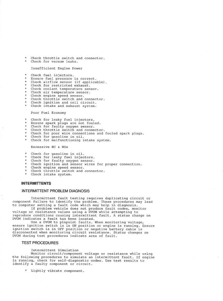

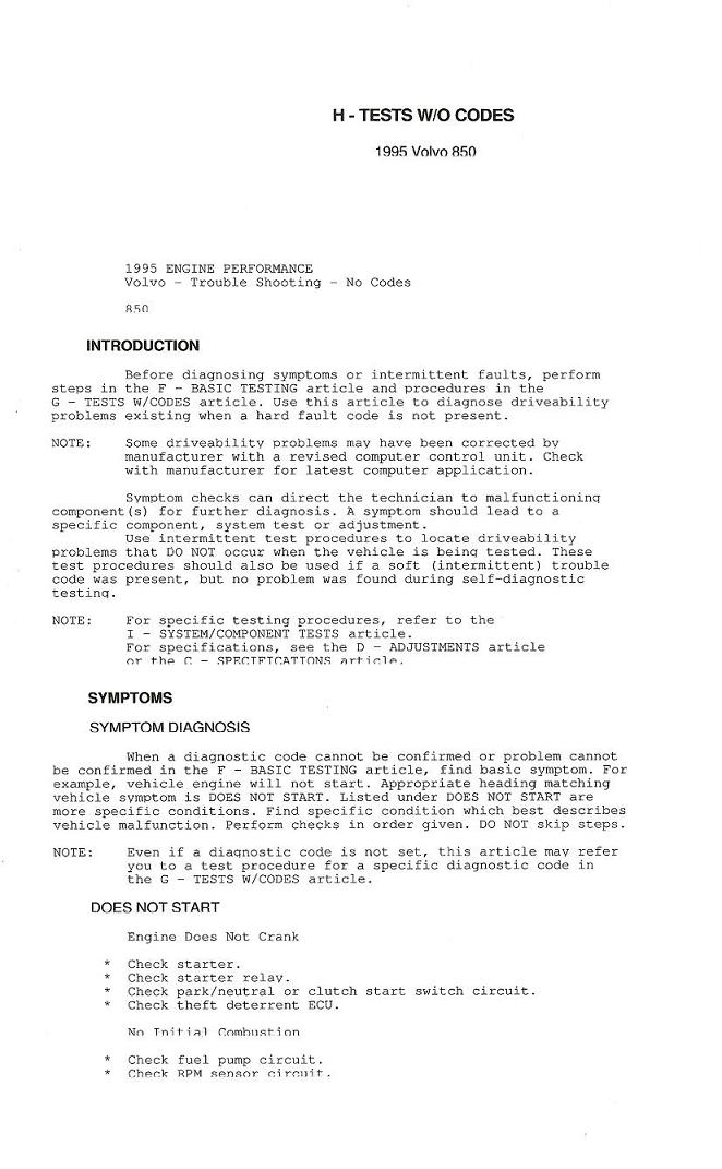

Default Ref for wooper999
I hope they are of some use.
JPN
Attached Thumbnails 94 volvo 850 Turbo sudden no start-850-turbo-drivability-problem-2-.jpg   94 volvo 850 Turbo sudden no start-850-turbo-drivability-problem-3-.jpg   94 volvo 850 Turbo sudden no start-850-turbo-drivability-problem-4-.jpg

JPN,
Your troubleshooting checklist is hard to read.
Any possibility to blow it up and repost, or email me the attachments to gokihwan@gmail.com?
Thanks!
1996 Volvo 850 Turbo - 126K miles

OK, let me try it again.
In case if you want one:
http://www.volvoclub.org.uk/volvo_wo...techdocs.shtml
