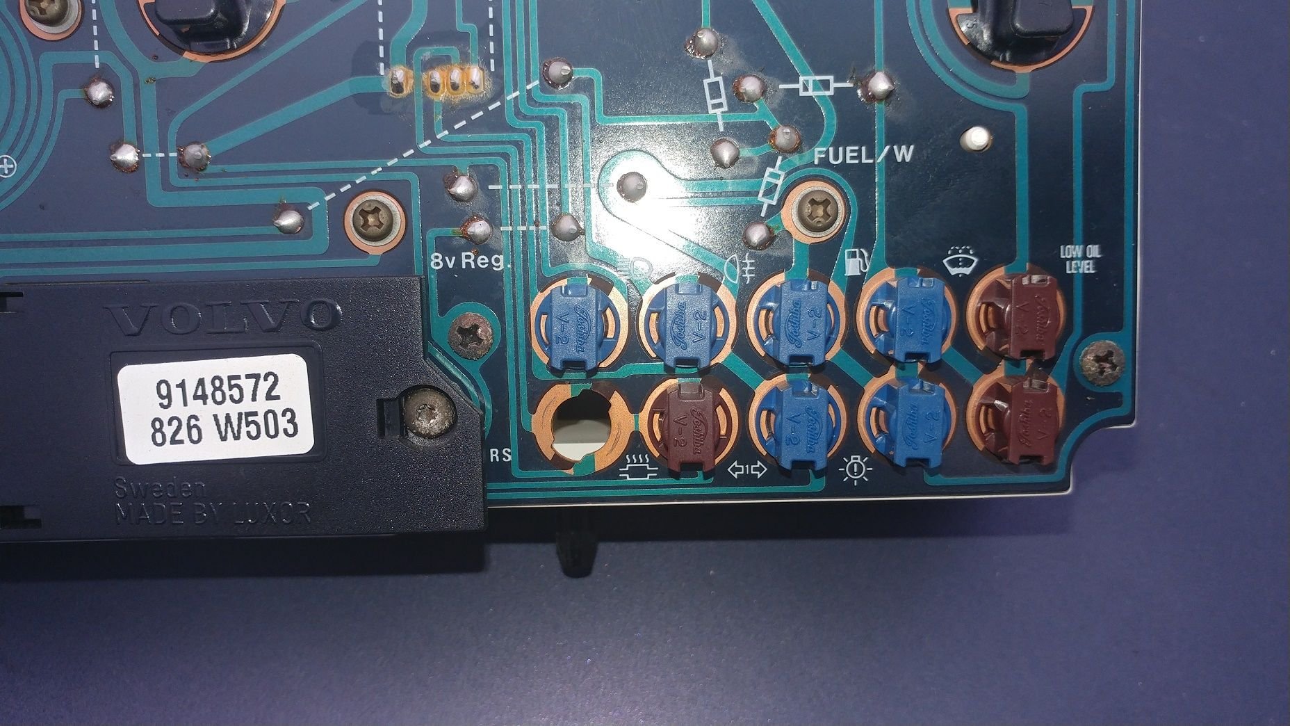

I removed the instrument cluster and I'm surprised to find there's NO BULB there! Another thing I found is the clip of the instrument cluster has not been put on. That explains why it always shake when the car's running. Not sure whether the SRS bulb is shaken off. I put the wind shield washer light to the SRS position and it works as expected. I think the problem is solved now. I just need to find a bulb with socket to put on.
