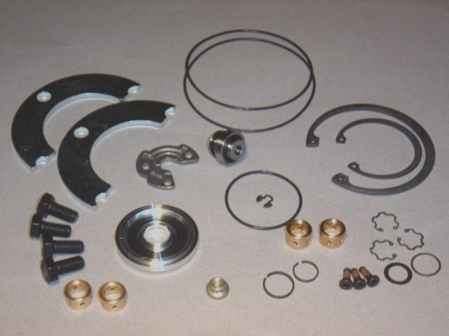

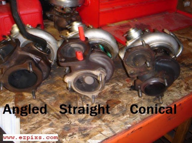

The '95 850 is the one year you might have a conical outlet on the exhaust. If the one you have is a straight flange and the used one comes with a conical you can swap the exhaust housings. You'll need a different down pipe but the straight or angled are more common and easier to work with in the long run. If you're keeping it stock you can stick with the conical since it would be the easiest swap and not need anything. If you're thinking of doing anything performance wise now would be a good time to swap out the conical IMHO.
If you are buying the one on Ebay that says it has some side to side play you'd be better off just buying the $35-$100 rebuild kit and rebuilding it or having a friend do it for you. No telling when the new, used turbo will start leaking just as bad as the one it's replacing.

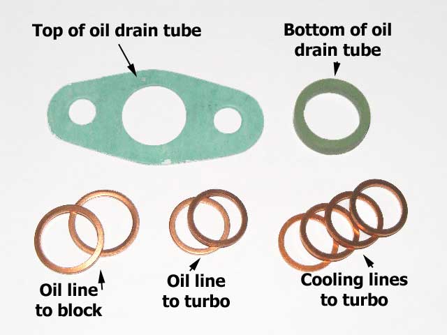

Remember to get new copper "O" rings and gaskets for the install as using the old ones is always a bad idea.

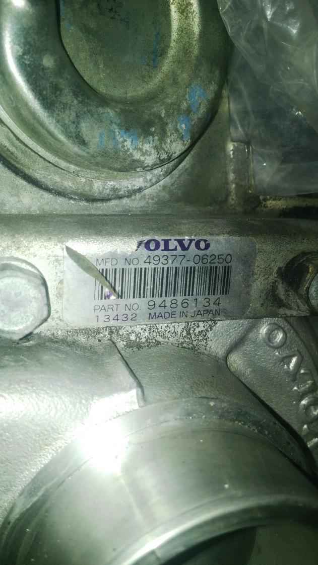

Thanks a million Kiss4aFrog!!! Are all the turbos td04's? I ask because the one i just got does not say. I'll attach a pic to show you. Are the"o"rings and gaskets only available with the rebuild kits?

just be sure its not simply the oil return gasket pictured in K's post. A bad gasket there can push oil all over the place - I've had to replace it twice in 200K miles on my 95 850T. To your question on the turbo model - 850s have the TD04HL-15G turbo - the V70s came with the 16T and some of the newer bigger brutes have the 18T. Its a common bolt on upgrade to drop the 16T into an 850, particularly if you are upgrading the ECU and adding a downpipe.. I did some looking that that P/N seems to be matched to a 12T used in the S40 4 Cyl. Best to pass - Another option for a used part is Car-Part.com--Used Auto Parts Market - Looks like you can find a used one for $100 or so... I usually search car-part.com, find a yard within driving distance, call ahead and pick up with no wait. Just did the ABS pump on my S40 for $75 that way...from a yard 20 miles away too.
Old Jan 22, 2015 | 08:52 PM
Mt6127 is correct. That is a #49377-06250 and it's a 12T or even simpler, it's smaller than the one you have now. NOT a good idea to go smaller.

The rebuild kit is the way to go but most parts are all available separately. The copper O rings and gaskets for the swap used to come in a kit but now you have to buy them separately on line or from a dealer. No clue what they aren't in the rebuild kit.

Your 95 850 turbo came with a TD04-15G. Sounds like you are only interested in getting that replaced, nothing performance. If so, buy a rebuild kit and fix your existing turbo up. An extremely common leak point is where the turbo oil drain tube meets the block, that seal needs to be replaced.
