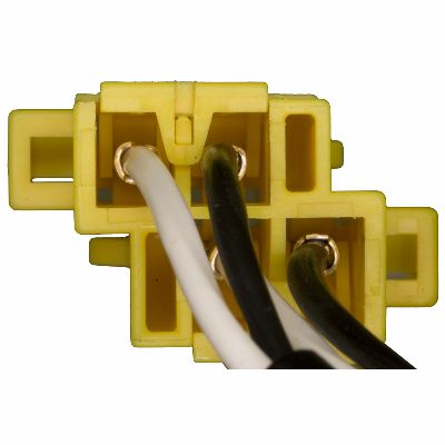

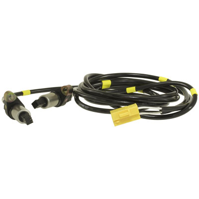

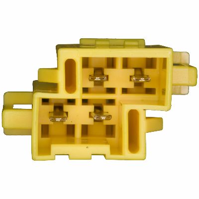

I haven't done them but from the pictures of the sensors themselves the connectors are not weather protected. They have to come through the body and be connected inside the body. There should be a rubber plug the wiring comes through. Under the floor in a wagon or trunk/under back seat in a sedan.
It's raining and chilly or I'd go out and try to find it for you
Attached Thumbnails 97 850glt-abs-sensors-rear-pair.jpg   97 850glt-abs-sensors-rear-connector-inside.jpg   97 850glt-abs-sensors-rear-connector-outside.jpg
